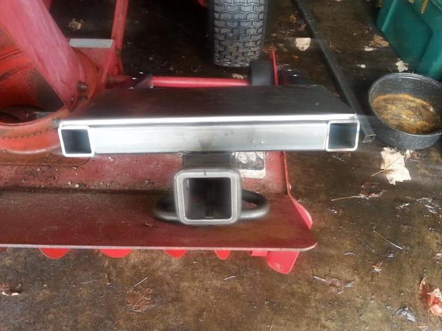

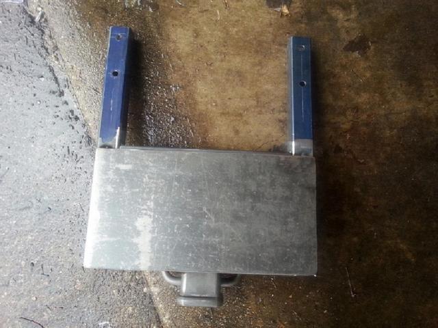

Joefrommi65 26 #11 Posted March 11, 2014 Thanks for responding Don!!!!! This is what I have so far I plan on attaching the tubing to the top of the rear axle and I have fabed up brackets to attach to the exiting hitch on the transaxle for support, I was just wondering what would be a good location to brace under the seat? Thanks again,Joe Share this post Link to post Share on other sites

Don1977 605 #13 Posted March 12, 2014 I don't know how thick the top of the transmission is my c-120 has two bolts the hold the rear fender and seat. I had one to parochially strip and wouldn't stay tight. I installed a 1/4" longer bolt to get it to tighten up. Don't thing I would use those for a winch mount. Share this post Link to post Share on other sites
