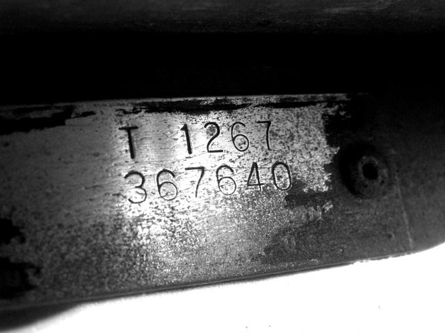

sorekiwi 761 #10 Posted November 30, 2013 Nope, its a drive belt Kiwi. Well I'll be... The number I have for the 1276 is 9714 (I probably got that # from the "lube rec" manual. This cross references to a Gates 6876. A 1586 also cross references to a Gates 6876. A reverse parts look up on a 1586 lists it as a v belt for the SR64 speed reduction kit, or a Hy2 or Hy3 hydraulic unit. No mention of the 1267. I absolutely love my 1267. I bought mine kinda by accident, but once I got it sorted out it has been a great tractor for me. Unfortunately last year I decided to mount a tiller on it and as such I haven't used it very much at all recently. Probably need to switch the tiller to something else, I need my 1267 back! Share this post Link to post Share on other sites
