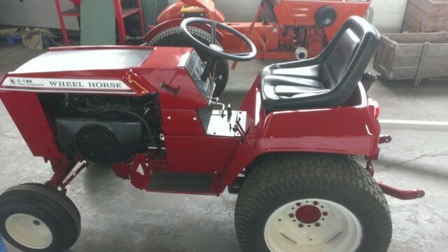

btm1970 97 #3 Posted November 29, 2013 I have that size on mine. it works fine. 1 Share this post Link to post Share on other sites
edwroy 138 #4 Posted November 29, 2013 Looks great - what rims did you use? 1 Share this post Link to post Share on other sites
btm1970 97 #5 Posted November 29, 2013 used the original ones Share this post Link to post Share on other sites

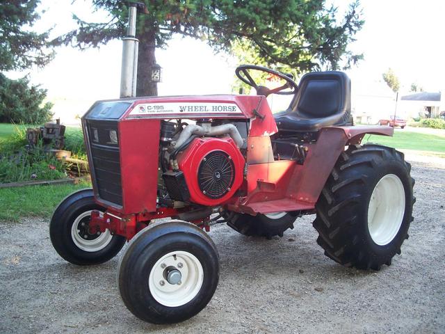

Digger 66 3,525 #6 Posted November 29, 2013 (edited) Looks great - what rims did you use? Are you looking for " tri-ribs " ? ( http://www.greaterclevelandtire.com/servlet/the-1190/3.50-dsh-8-4P-Deestone-F-dsh-2/Detail ) Or "ribs" ? ( http://www.greaterclevelandtire.com/servlet/the-2196/18x8.50-dsh-8-4P-Deestone-Rib/Detail ) I put the " tri's " on mine & no more sideways slippage : Edited November 29, 2013 by Digger 66 2 Share this post Link to post Share on other sites

userj8670 68 #9 Posted December 2, 2013 Looks great - what rims did you use? Are you looking for " tri-ribs " ? ( http://www.greaterclevelandtire.com/servlet/the-1190/3.50-dsh-8-4P-Deestone-F-dsh-2/Detail ) Or "ribs" ? ( http://www.greaterclevelandtire.com/servlet/the-2196/18x8.50-dsh-8-4P-Deestone-Rib/Detail ) I put the " tri's " on mine & no more sideways slippage : Now that's a nice looking machine there Gene! 1 Share this post Link to post Share on other sites

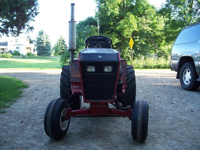

Kelly 1,037 #11 Posted April 9, 2014 I have the 16x6.5x8 Firestone tri ribs on mine, not stock rims but are the same width as stock 5 3/8" wide I do believe, no don't use the 4x8 they will be way to small. 2 Share this post Link to post Share on other sites
varosd 1,185 #12 Posted April 9, 2014 Kelly, that is one scary looking beast! Share this post Link to post Share on other sites
chip61 666 #13 Posted April 9, 2014 Kelly, nice looking setup! Looks ready to take on any job. Share this post Link to post Share on other sites

Ken B 3,202 #20 Posted April 10, 2014 Kelly I was hopin you'd post a pic of that C-195! Totally BAD TO THE BONE. 1 Share this post Link to post Share on other sites
ollie4816 0 #21 Posted April 10, 2014 What size rims are on the front and back of a wheel horse commando 800 Share this post Link to post Share on other sites
AMC RULES 37,254 #22 Posted April 10, 2014 26x12's on the rear Kelly? Share this post Link to post Share on other sites
