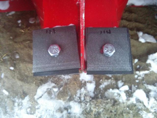

roscoemi 245 #6 Posted November 28, 2013 Not sure there is anything more aggravating,I had the same problem on my c series blower last year. About a month ago I pulled it apart and painted the auger, chute and tunnel. I also added rubber belt material to the flats on the center of the auger. No problems this year, it tried to clog a couple times but I backed off for a few seconds and it cleared right out. 2 Share this post Link to post Share on other sites
Trouty56 567 #7 Posted November 28, 2013 Not sure there is anything more aggravating,I had the same problem on my c series blower last year. About a month ago I pulled it apart and painted the auger, chute and tunnel. I also added rubber belt material to the flats on the center of the auger. No problems this year, it tried to clog a couple times but I backed off for a few seconds and it cleared right out. pics of that rubber belt would be great..... 1 Share this post Link to post Share on other sites

roscoemi 245 #10 Posted November 28, 2013 Here is the rubber pieces that I used to extend the augers in the center to help prevent clogging. They have about a 1/16" clearance in the tunnel, but do rub slightly at the bottom due to the damage of being used on a gravel drive for years. The combo of slick new paint with nothing to stick to, and much smaller clearances at the business point have helped tremendously. I used material for making drive belts for tractor implements from TSC to make mine. I never had any luck with spray or wipe on stuff, it just wears off in minutes. 2 Share this post Link to post Share on other sites
