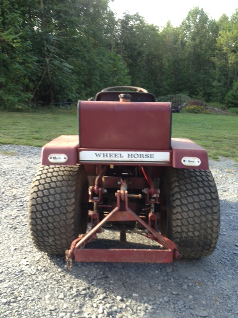

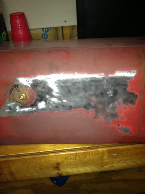

Jacksonbros 55 #1 Posted November 26, 2013 A couple of months ago, I bought a D-200 that I knew had a hole in the gas tank. It was pretty rusty inside. I finally got around to patching the hole and was going to start the process of using apple cider vinegar to clean the rust. I put a little vinegar in it and 30 minutes later, the vinegar was on the garage floor and then I counted 21 very small holes in the bottom of the tank. Does anyone know of a way to repair this or would it be better to buy another tank? Does anyone have one for sale? Share this post Link to post Share on other sites
Trouty56 568 #2 Posted November 26, 2013 There are a few "liner" products out there....YouTube has lots of videos using different products...motorcycle restorers use tank liners frequently.... Por 15 has a product..... Share this post Link to post Share on other sites
brandonozz 168 #3 Posted November 27, 2013 Just as Bob mentioned, I have used the fuel tank sealer in a motorcycle tank with very good results. My leak was the seam in the bottom edge on one side. Worked for at least two years before I got rid of the bike. As to weather it would work on a tank that thin in so many places your guess is as good as mine. Share this post Link to post Share on other sites
