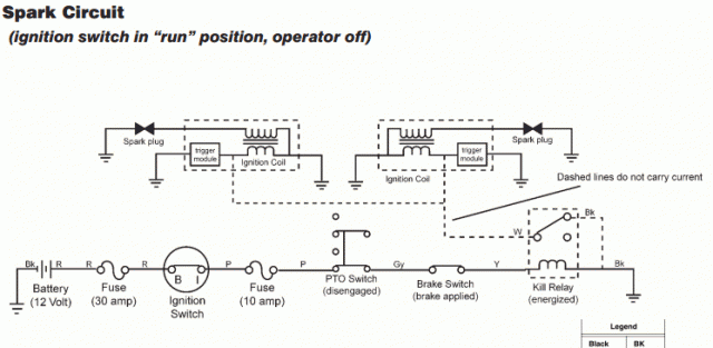

Save Old Iron 1,573 #20 Posted November 20, 2013 (edited) Doc, Rick interestingly enough, the seat switch is ignored on the 98 models and is monitored on the 99+ year models. I have a 1998 518xi. Hate to disagree, but it is monitored, the same that year also. Interesting. This wouldn't be the first mystery made deeper by the demystification guide. The circuit in the Toro demystication guide for the 1998 522xi shows the seat switch is not monitored for kill purposes. (don't know about the 518xi ). Per the schematic below, the PTO needs to be disengaged and the BRAKE safety switch ON. The SEAT switch will certainly become a player when the PTO switch is engaged. Regardless, Bob states he has a 99, and he has removed the KILL wires from the mags. Under these conditions, the status of any safety switches should become irrelevant. Unless........ something like a kill signal from the oil pressure sensor sends a kill signal to the SAM module. I don't believe the KILL signal comes into or goes thru the SAM. Back to the schematics to check for sure. . . . Edited November 20, 2013 by Save Old Iron Share this post Link to post Share on other sites
Save Old Iron 1,573 #21 Posted November 20, 2013 I've gone over all the information again that you sent me and it seems to come down to the Smart Spark unit or the kill switch relay . Do I have to find a shop with a Smart Spark tester - either 25 761 21 S or 25 761 40 S Can this test be done with the SAM completely removed from the tractor? Bob, if you have removed any possibilty the mags are grounded (by removing the KILL wire at the mags) AND you have confirmed 12 volts available to the SAM module when it is cranking, I agree the SAM module is highly suspect. I have never experimented with a Toro SAM but the operation theory remains the same. The SAM senses the engine RPM and introduces a delay to the 2nd "FIRE" terminal on the mag(s). As the engine RPM increases, the SAM will gradually cut back on the delay it introduces and effectively advances the spark to the mags. More delay at low RPMS = easier starting, less delay / more advance at higher RPM = potentially more power. The logic then boils down to: IF the kill relay is NOT grounding the mag kill termnal AND the engine RPMS are above 550 And the SAM is powered up and functional Then the SAM calculates a delay appropriate to the current RPM of the engine and sends an output signal on the BROWN wires to the mags The mag(s) then fire if they are functional. p.s. since both "FIRE" wires on the mags are color coded BROWN, they are most likely interchangeable. I'm not sure if the physical length of the wires will prohibit interchanging them. The point is both mags are likely fired at the same time and if one mag is bad, the other should fire. If neither fire, the SAM appears the likely culprit. Share this post Link to post Share on other sites
Rick_in_CT 156 #22 Posted November 20, 2013 I have come to the same conclusion as Save Old Iron, it is really looking like the SAM as long as the kill relay has been confirmed as ok. If you have a Wheel Horse/Toro dealer in your area, I would give them a call and see if they can test the SAM. The Kohler manual says that the SAM can be tested removed from the engine. I have not been able to confirm if the oil pressure switch is tied into the SAM or not, but I would make sure that the crankcase has the correct oil level. Share this post Link to post Share on other sites
WH nut 553 #23 Posted November 20, 2013 By looking at the diagram, if all wires are removed from the mags you should have spark. By the diagram ground the mags is all any wire does. Share this post Link to post Share on other sites
