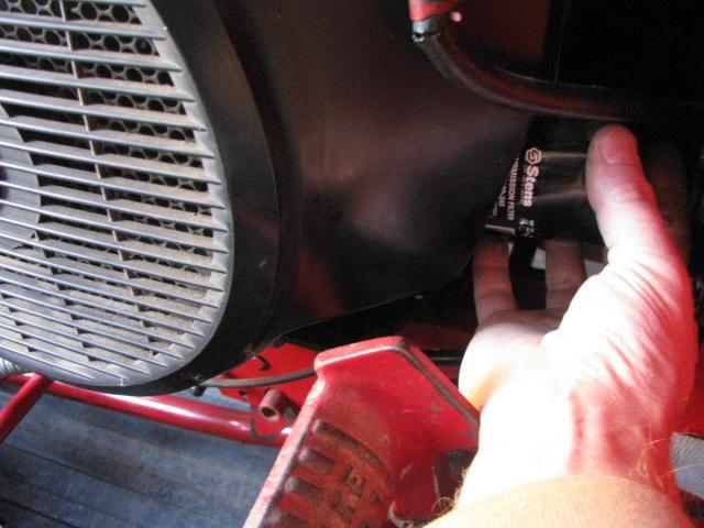

Need to change the oil on my 1989 520 HC.  Do i need to remove ther shrouds on the 20 hp onan engine to change the oil filter ?  I tried to remove the shrouds once and it was a little bit more than i wanted to get into at the time. thank you

Facing the left side of the engine, down low on the bottom right corner...directly behind your brake pedal...you should be able to see the bottom of your filter sticking out.
Should be enough room to reach in there and get the filter out...might need a filter wrench, or punch a long screw driver through it to get it to turn it though.
Edited by AMC RULES
shorts
Someone, maybe KD tools used to make a cup type filter wrench that fit over the end of the filters that worked good.  Try your local auto parts and have them look in their specialty tool catalog, if that doesn't work look online for a SnapOn catalog or dealer.
Tip, try to break the filter loose by hand while the engine is running, the oil pressure on  the gasket from the inside will help to loosen the oring seal

Go Napa and get an longer OEM eq. Filter and they should be able to give you a cup wrench the right size.

AMC RULES
See...lots of room in there.   :handgestures-thumbsup:
