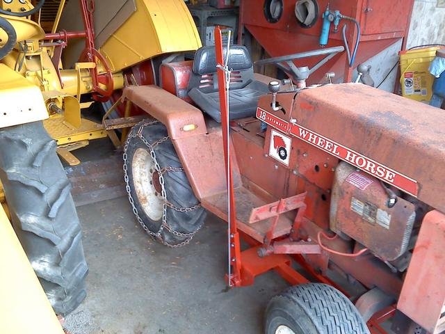

glgrumpy 35 #1 Posted November 3, 2013 (edited) Well, got the D series blade lever done! I used channel iron at bottom for connection with bolts, not the slip-over with pin that is in instructions, and made my own pull trigger, just like a real Horse one. I DO good work......"pat on back"! NOW! Where and How for a rubber grip on that end? Well says my pix too big, not sure why NOW and do all the time, but just one for now @#$*&! Edited November 3, 2013 by glgrumpy 3 Share this post Link to post Share on other sites
timo4352 148 #2 Posted November 3, 2013 (edited) Blade angle-r lever? I hope you get the picture thing sorted - I'm interested in seeing more. The plow I just put together for mine does not have 'angle from the seat' capabilities - I'd like to change that... You handle looks damn good to me. Rubber grip? How about a piece of rubber hose slipped over - or Plasti-dip? Edited November 3, 2013 by timo4352 Share this post Link to post Share on other sites
glgrumpy 35 #3 Posted November 3, 2013 Pix won't fit. Did on G-talk with same system, not sure why not here. They have automatic sizing or something I think. Also they show smaller prints in the message to click on and make bigger. Moderators>>>>>are you listening?? All the Horse blades have anout same system, you don't have horse blade? On most the lever is bolted on and the big rod comes from frame and direct to the lever. There is wires that go from there down to pivot link and up to the big position pin in center of the blade mount pivot. Look at any manual on blades here and you will see. This D series gets more complicated in the linkages and such, but basically is the same. Plasta dip was in my mind, but haven't had good luck with that stuff being durable in past. maybe it was too old. Didn't stay flexible and broke off in chunks! Would need to be pretty big hose and might be too thick if I find one to fit over handle?? We'll have to try some stuff. Share this post Link to post Share on other sites

stevasaurus 23,521 #5 Posted November 3, 2013 That handle looks great. Just thinking what you might put on the handle part...how about some nylon or cotton twine / rope...maybe 1/4" and tie a series of half hitches and whip the end to get the tag end pulled down into the wrappings. I was in the Navy. Another option would be to make a wood handle...drilled out and sanded down on the outside to fit...could even drill and tap to hold it in place...walnut or oak stained would be a very nice touch. Share this post Link to post Share on other sites
shorts 182 #6 Posted November 3, 2013 wrap the handle with 1/4'' nylon rope and then coat it with liquid electrical tape or slide a couple of layers of shrink fit battery cable insulation over it and your good to go. Share this post Link to post Share on other sites

boovuc 1,090 #8 Posted November 4, 2013 Plastic dip or the heat-shrink insulators I used to install a submersible well pump many moons ago! 1 Share this post Link to post Share on other sites
953 nut 63,335 #9 Posted November 4, 2013 That is one stout brackit you built! Nice job. Share this post Link to post Share on other sites
KC9KAS 4,745 #10 Posted November 4, 2013 (edited) A 1" diameter plastic grip will fit it. glgrumpy, PM me if you can't find one locally, as I have one. I sent you a PM. Edited November 5, 2013 by KC9KAS 2 Share this post Link to post Share on other sites
