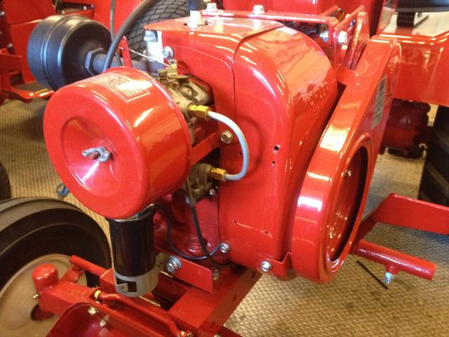

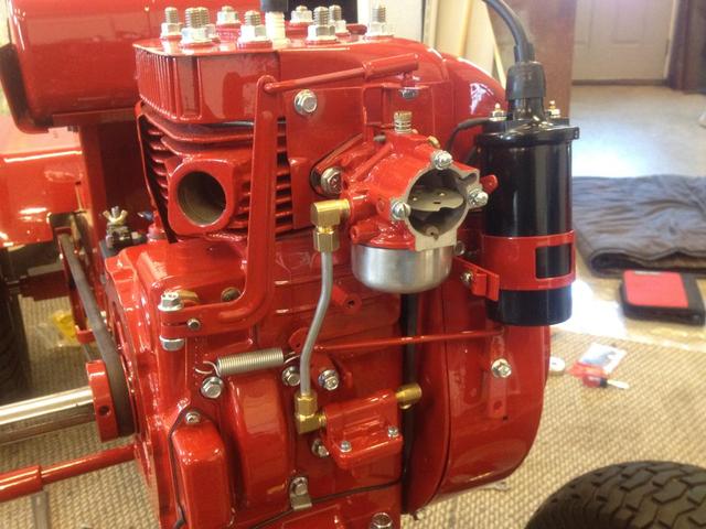

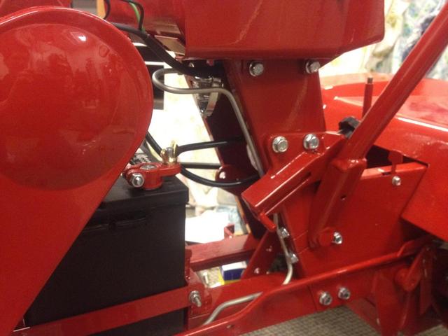

Martin 2,133 #6 Posted November 3, 2013 I'm sorry, i misread your title.... yes like the others said you can use soft copper or rubber fuel line and fittings. i have replaced mine with brake line (bundy tubing) and 1/4 compression fittings on most of my tractors with good results. the soft copper like steve mentioned would seal easier than the bundy tubing, but I've had no leaks on any of mine that I've replaced...... heres a typical installation of mine with the bundy and compression fittings....... 1 Share this post Link to post Share on other sites
stevasaurus 23,661 #7 Posted November 3, 2013 Dang, Martin, That picture just looks fantastic...I think I have been looking at it for about 15 minutes now. Is that bundy tubing flexible...like soft copper or do you need a bending spring??? I have not seen that before. Share this post Link to post Share on other sites

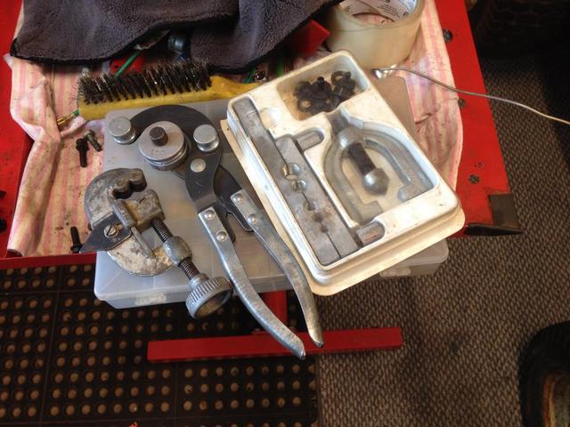

Martin 2,133 #9 Posted November 3, 2013 (edited) you need a bender steve. heres all the tools you need to cut, bend and even single or double flare if you need to...... in order to create lines like this. i like to keep things looking tidy if you know what i mean........ Edited November 3, 2013 by Martin 4 Share this post Link to post Share on other sites
stevasaurus 23,661 #10 Posted November 3, 2013 Yes, I thought so...used those tools back in the old days at the gas station I worked at...some times we would make and bend our own brake lines (and they had the flared ends). Very cool...you are a craftsman Martin...those pictures look great. I would not mind having a set of them to use, but it would be once in a great while. I have a real good set of bending springs for using soft copper...makes it look OK and it works...but I probably would not look at the picture for 15 minutes. 1 Share this post Link to post Share on other sites
