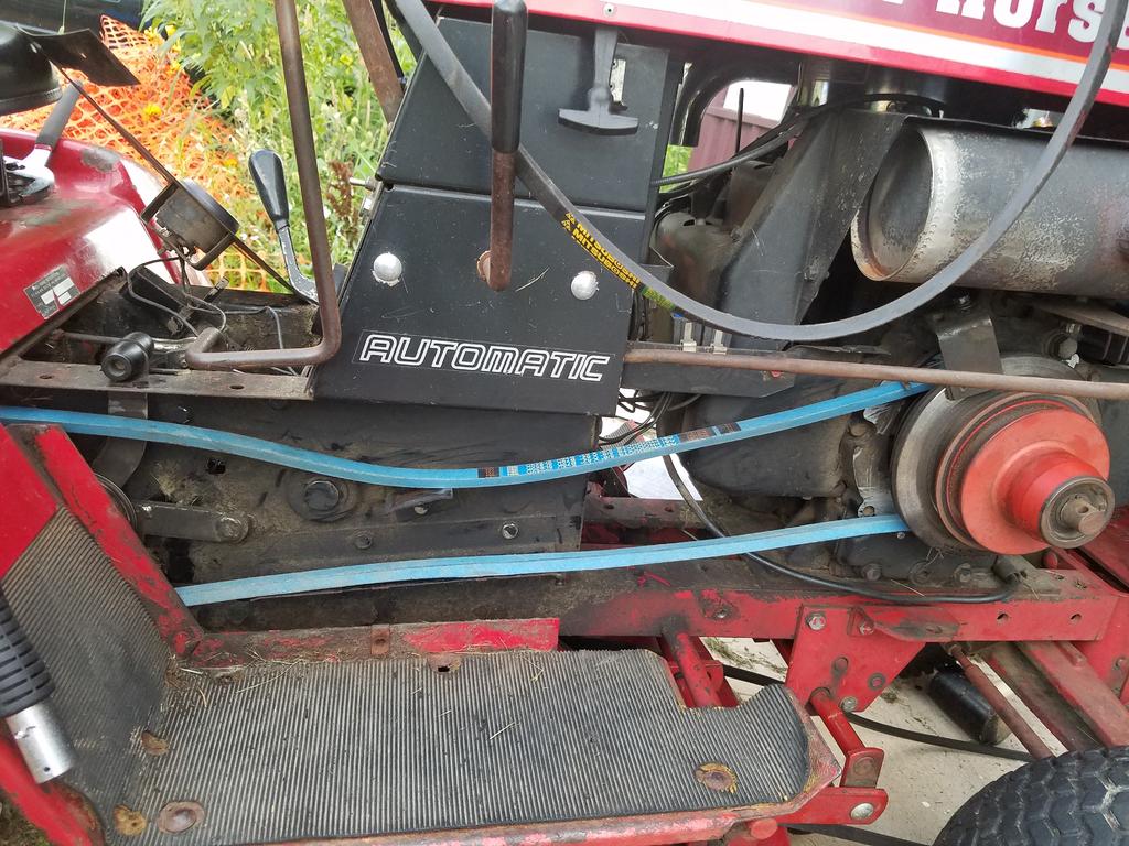

Jenna 6 #5 Posted August 3, 2019 Thank you for posting this picture! I found an 417-a with a snow blower and cab. My husband things I'm crazy for getting it. It was working great until the drive belt broke. I thought easy fix but holy cow and a half it was driving me crazy then I realized I had the wrong size belt 1 2 Share this post Link to post Share on other sites
953 nut 64,126 #6 Posted August 3, 2019 22 minutes ago, Jenna said: I realized I had the wrong size belt The 417 is a wonderful worker. I have had good luck with the Kevlar belts from Tractor Supply. The B-79 (5L-820) should work. Share this post Link to post Share on other sites

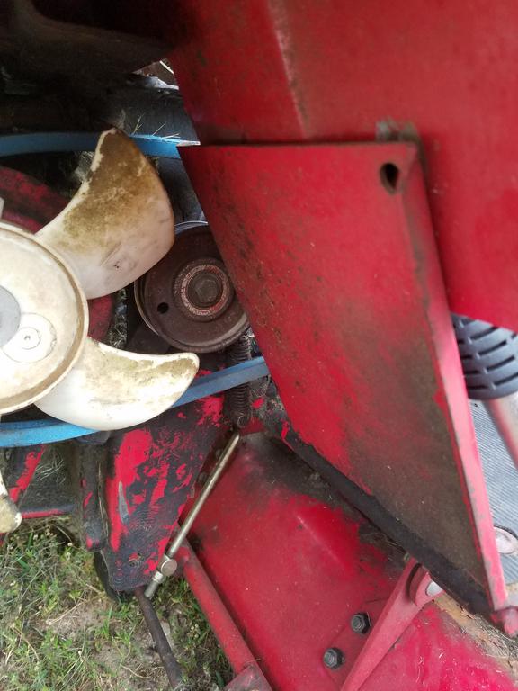

Jenna 6 #7 Posted August 5, 2019 How do I run the belt over the this clutch pully( not sure of the name ) Share this post Link to post Share on other sites

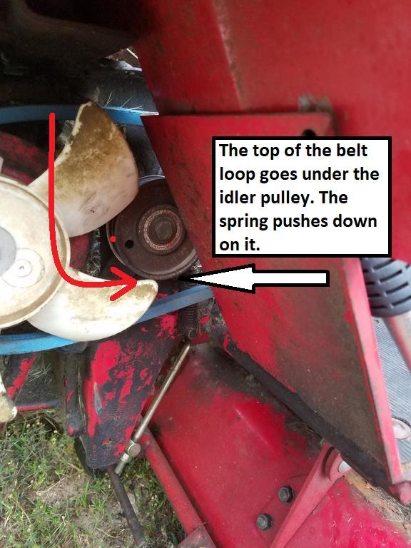

wallfish 19,321 #8 Posted August 5, 2019 8 minutes ago, Jenna said: How do I run the belt over the this clutch pully( not sure of the name ) Share this post Link to post Share on other sites
Jenna 6 #9 Posted August 5, 2019 Thank you thank you thank you!!! Share this post Link to post Share on other sites
