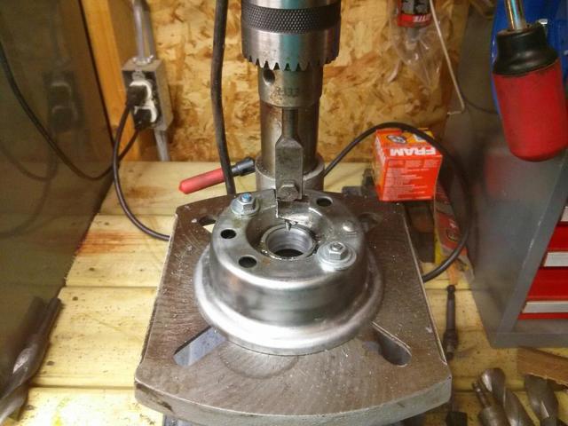

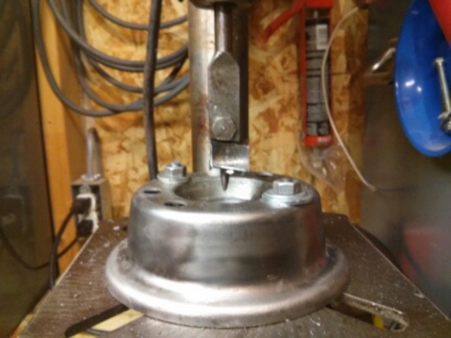

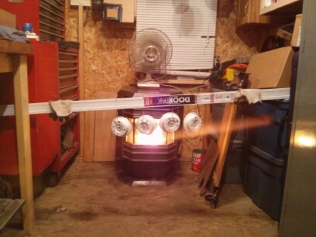

roscoemi 245 #31 Posted November 7, 2013 I bought some tri ribs for P'Chops ranger for his birthday, but needed to do some fixes before mounting them. Some time in it's life it was run a long time without grease in the front wheels, roaching the steel bushings. Ordered some brass ones from McMaster Carr, and went about putting them in last night. I chucked the wrong drill bit in the press and ended up drilling a 15/16" hole instead of a 7/8" hole. Today I picked up a 3/4 x 1 bushing and started over, but the 1" bit wanted to drill 1 1/8". Put that wheel half off to the side and did the other three in no time. Not wanting to spend $50 on a drill bit to do one hole, I experimented. I took a adjustable wood bit I got from the wife's grandfather, cut the shank down and reground the cutting edge and made a boring bar out of it. And it actually worked! After cleaning and painting, low temp baking. 1 Share this post Link to post Share on other sites
