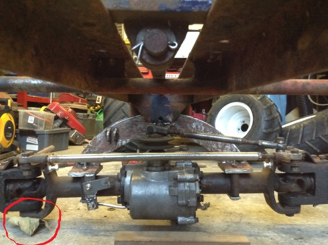

meadowfield 3,141 #66 Posted November 13, 2013 Here's a small update... Firstly the adjustable steering end stops Steering setup from the back, re using as much of the original as possible All adjustable with almost no bump steer. No idea how heavy this thing is going to be on steering though.... 1 Share this post Link to post Share on other sites
Stigian 1,235 #67 Posted November 14, 2013 Good to see some more progress Mark, I hope your trapped nerve sorts it's self out soon. A thought on the (maybe) heavy steering.. You could always fit electric power steering. The kind that operates on the steering column.. If you use a system out of a Fiat Punto you could even install the "girly mode" button that would make the steering so light a gentle breeze could make the wheels turn Share this post Link to post Share on other sites
Anglo Traction 761 #68 Posted November 14, 2013 Good to see some more progress Mark, I hope your trapped nerve sorts it's self out soon. You could always fit electric power steering. The kind that operates on the steering column.. If you use a system out of a Fiat Punto you could even install the "girly mode" button Oh laugh!. I nearly bought my own Beer!. ..........................Is there a place for one of those on a WH?. I'm Amazed at the strength of the Yorkshire dead leaf holding up the L/H front corner in Mark's 3rd pic from yesterday! Hope your back fixes quick Mark. Don't overdo it. Great progress and liking it 1 Share this post Link to post Share on other sites
meadowfield 3,141 #69 Posted November 14, 2013 Good to see some more progress Mark, I hope your trapped nerve sorts it's self out soon. A thought on the (maybe) heavy steering.. You could always fit electric power steering. The kind that operates on the steering column.. If you use a system out of a Fiat Punto you could even install the "girly mode" button that would make the steering so light a gentle breeze could make the wheels turn I have already thought of electric power steering for bendy... However I can't find a unit that doesn't run through the ecu, which makes it tricky! Girly mode... Pah! Good to see some more progress Mark, I hope your trapped nerve sorts it's self out soon. You could always fit electric power steering. The kind that operates on the steering column.. If you use a system out of a Fiat Punto you could even install the "girly mode" button ATT41.gif Oh laugh!. I nearly bought my own Beer!. ..........................Is there a place for one of those on a WH?. I'm Amazed at the strength of the Yorkshire dead leaf holding up the L/H front corner in Mark's 3rd pic from yesterday! leaf.jpg Hope your back fixes quick Mark. Don't overdo it. Great progress and liking it Thanks Richard, never spotted the leaf Might be coming to you for some lathe advice... Looking for the simplest way to cut key ways using a myford ML7 and I think you might be the man. Share this post Link to post Share on other sites
Stigian 1,235 #70 Posted November 14, 2013 Good to see some more progress Mark, I hope your trapped nerve sorts it's self out soon. You could always fit electric power steering. The kind that operates on the steering column.. If you use a system out of a Fiat Punto you could even install the "girly mode" button ATT41.gif Oh laugh!. I nearly bought my own Beer!. ..........................Is there a place for one of those on a WH?. Hehe, nah I don't expect there is Richard... Unless a seriously overloaded front end loaded is used Good to see some more progress Mark, I hope your trapped nerve sorts it's self out soon. A thought on the (maybe) heavy steering.. You could always fit electric power steering. The kind that operates on the steering column.. If you use a system out of a Fiat Punto you could even install the "girly mode" button that would make the steering so light a gentle breeze could make the wheels turn I have already thought of electric power steering for bendy... However I can't find a unit that doesn't run through the ecu, which makes it tricky! Girly mode... Pah! All you need is a high tech ZX81 to plug it into Mark Share this post Link to post Share on other sites
