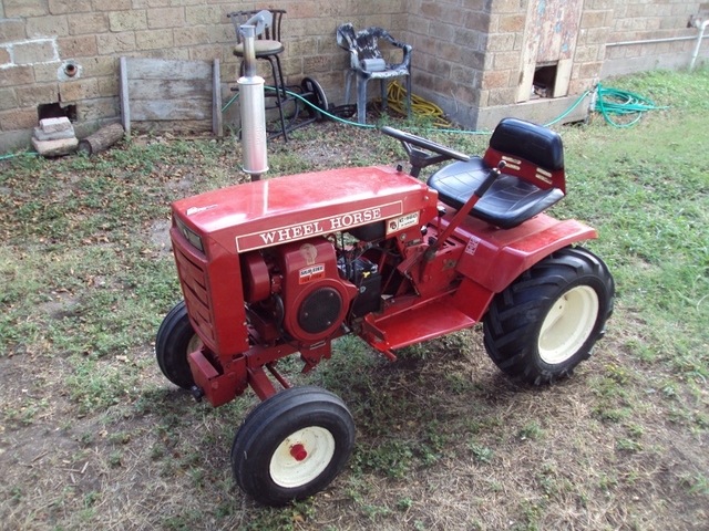

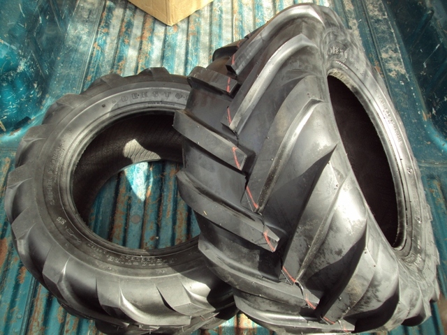

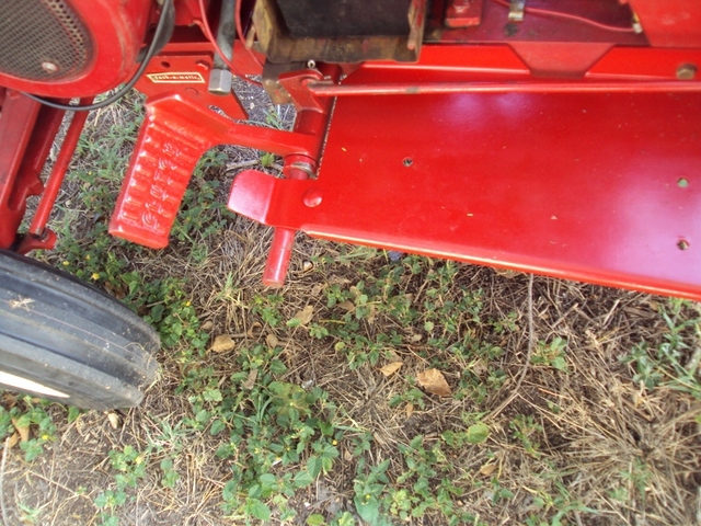

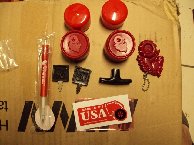

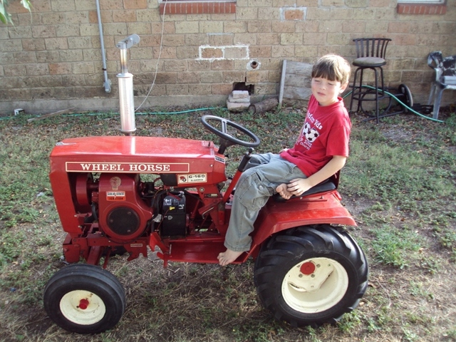

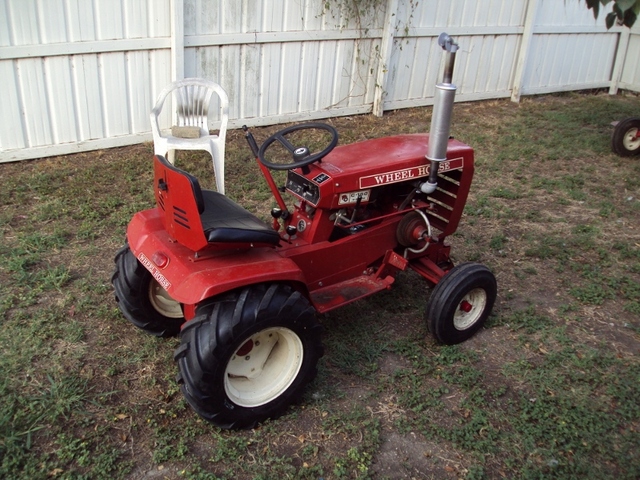

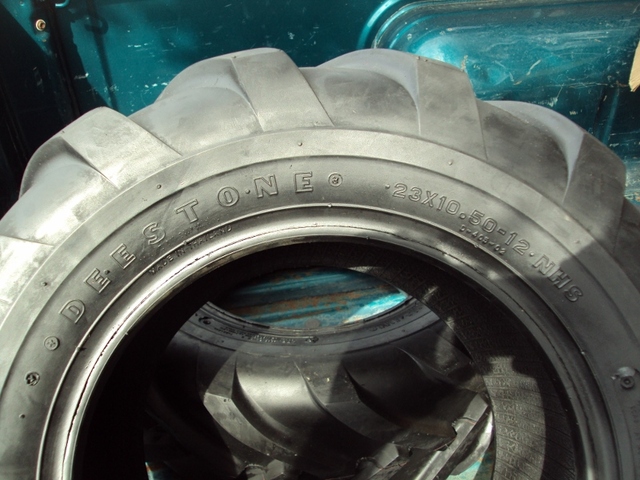

bowtiebutler956 650 #55 Posted November 1, 2013 (edited) Well, I've been out of town for a few days, and just got back last night, so I hadn't got much done on it. However, when I got back I had a couple things that had come in the mail. I got a care package from Glen Pettit, including a repro throttle knob, and a few other items. Glen does great work!! I also got some 23x10.50-12 AG's, and some tri-ribs. The clutch pedal came in as well, so now it drives. Here are a few pics. Matt Edited November 1, 2013 by bowtiebutler956 8 Share this post Link to post Share on other sites
Hydro 131 #56 Posted November 1, 2013 Are those 10.50's on a smaller sized rim? They look great. 1 Share this post Link to post Share on other sites
Terry M-(Moderator) 2,329 #57 Posted November 1, 2013 Nice AG's and tri's you have there Matt!! And overall the tractor is turning out to look really sharp ! But Actually that's no surprise. Oh, I think your tractor maybe taken from behind your back by some small person in a red shirt. Be carefull pal... 1 Share this post Link to post Share on other sites
bowtiebutler956 650 #58 Posted November 1, 2013 Are those 10.50's on a smaller sized rim? They look great. They are on the original rims. They bulge off rims a little more than the original 8.50's, but not to bad. Thanks for the kind words. Matt Nice AG's and tri's you have there Matt!! And overall the tractor is turning out to look really sharp ! But Actually that's no surprise. Oh, I think your tractor maybe taken from behind your back by some small person in a red shirt. Be carefull pal... Thanks Terry. If Danny had it his way, all my tractors would be his!! That boy is a real chip off the old block! Matt Share this post Link to post Share on other sites

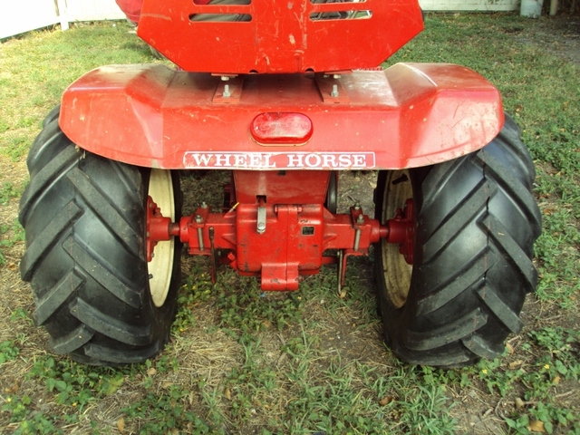

bowtiebutler956 650 #59 Posted November 2, 2013 Here is a comparison of the 8.50's on my B-80, and the 10.50's on the C-160. Matt 2 Share this post Link to post Share on other sites

bowtiebutler956 650 #64 Posted November 2, 2013 Looks Good Matt.. glad you finaly found a C160.. Thanks Lars, and I am glad I finally got a C-160. looking good matt. those tri ribs and ags are a great combination and look right on your tractor. I'm happy that kent wanted them for his tractor instead of turfs, dad wanted to put turfs on instead, but the tri's and ag's won out and look better i think........ makes me want to change another one of mine over from the turf savers on it now.......... how do you like the deestone ags? it was a toss up between them and the duros for kents tractor. ended up price on the duro was better so i went with them. looks like you got the deestone d401 on the front...... great tire for the money. Thanks Martin. I really like the AG's, and Tri-Ribs, as they just give it that "Big Tractor" look. I have had the Deestone's on my B-80 for almost 2 years, and lots of hours mowing. So far I've had no problems whatsoever, and I'm not even using tubes on the tri-ribs on my B-80 like they recommend. I just mounted them, and never had a problem. I went ahead, and used the tubes on the C-160, because they came with the tires, but if I ever get a flat, I'll probably just remove the tube, and install a valve stem. That tractor is looking fantastic john! You are always welcome to store it in my barn...I'll put it to use. Who's John? Thanks Jake, but its happy in its current stable, and if it saw the size of your stables, it would never want to come home! Matt 1 Share this post Link to post Share on other sites

userj8670 68 #66 Posted November 2, 2013 Where can I find one of those sweet looking keychains?! Tractor looks awesome! Where can I find one of those sweet looking keychains?! Tractor looks awesome! Share this post Link to post Share on other sites
bowtiebutler956 650 #67 Posted November 2, 2013 Where can I find one of those sweet looking keychains?! Tractor looks awesome! Where can I find one of those sweet looking keychains?! Tractor looks awesome! Right here in the vendors section. Here is a link to his keys page. Glens work is first class! Matt Share this post Link to post Share on other sites

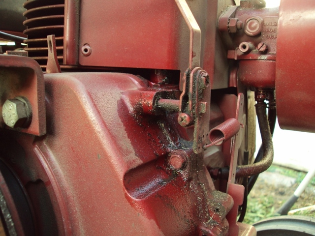

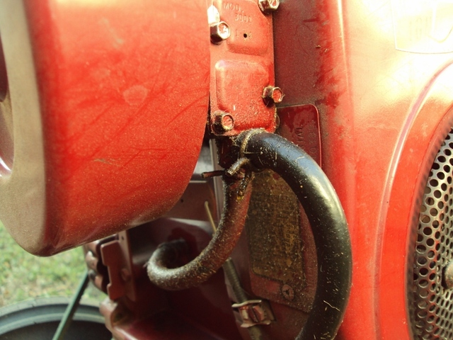

bowtiebutler956 650 #72 Posted November 7, 2013 Just thought I'd give a quick update. Before polishing it up any more, I decided to work it some, to see if any problems would arise. It took the place of my B-80 on mowing day (about 4hrs work), and it did great. Its a strong running animal. Although it performed very well, I had several leaks show themselves. The push rod tube seals started leaking, as can be seen in the pics. The fuel pump started leaking, so I ordered a rebuild kit. The transaxle also started leaking at the input shaft seal, as well as the brake drum seal. I'll deal with the engine, and fuel leaks ASAP, but will probably wait a little while on the rear end. I guess it has the right to leaks after sitting for so many years. Matt Share this post Link to post Share on other sites
dclarke 4,274 #73 Posted November 7, 2013 Here is a comparison of the 8.50's on my B-80, and the 10.50's on the C-160. Matt I like the 10.50's Matt. Good choice! 1 Share this post Link to post Share on other sites
Wheel-N-It 2,978 #74 Posted November 7, 2013 Matt, I can't swear to this as a cure but two of my WH's were weeping a bit of transmission oil when I bought them. One thing I always do when fitting up a new Wheel Horse is change the transmission oil to Lucas 85w-140. On both of these tractors I think the weeping has stopped. I have some axle seals here at the shop but have not needed to install them. Best of luck if you try this. Van 1 Share this post Link to post Share on other sites
