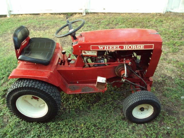

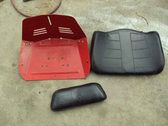

bowtiebutler956 650 #31 Posted October 26, 2013 Wow, thanks for all the great comments, and encouragement guys! The Tecky lives, and it runs Fantastic!!! No smoke, except a puff of black smoke when throttling up hard. I did the initial wash up on the today, including removing the shroud, and cleaning out the cooling fins before starting. All I did to was change the oil, new battery, and add gas, and it fired right up. I'm really starting to love this beast now! The clutch pedal is broken as can be seen in the pics below, but I've got a set of both clutch, and brake pedals on the way. I'm still really amazed by the seat, as its in fantastic shape, and the vinyl is still soft, and pliable. I think I'm going to have to put a stack on it. The Nelson muffler is in like new condition, so I'll save it, incase I decide I want to go back to original. I'm going to order a set of 23x10.50-12 ags as well. I introduced the C-160 to the B-80 today, and they get along quite well. Both of my :wh:'s are 1974 models, just like me. All of us are turning 40 next year! The hood really is raised much higher on this Tecky model, as can be seen in the comparison of it, and the B-80 below. Anyway, hear are the pics. I almost forgot to mention that the 88yr old woman I bought this from even gave me the original owners manual for the beast. Matt 5 Share this post Link to post Share on other sites

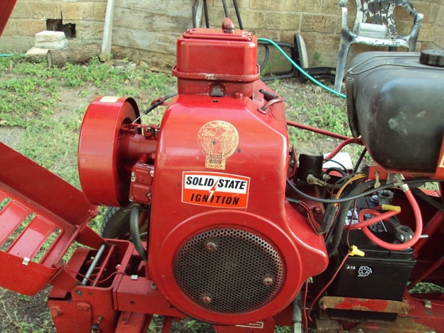

tbarnhart 240 #36 Posted October 26, 2013 OHV is what gives these Tec's the cool factor. They could be considered years ahead of their time for small engines, but the benefits are the same here as any other application. The OH160 has the same basic bottom end as the 12 hp HH120 with cast block, tapered Timken main bearings, and balance weights. The bore and stroke are the same, so parts like the piston, rod, and rings interchange. The blocks were adapted without valves and a different head and larger carb put in place. Instant 33% more power. The OHV design definitely breathes better and offers great fuel efficiency as well. Enjoy that Horse of another stripe! 1 Share this post Link to post Share on other sites

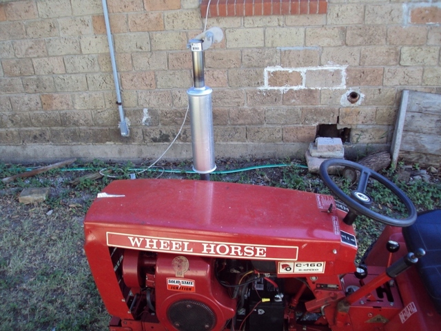

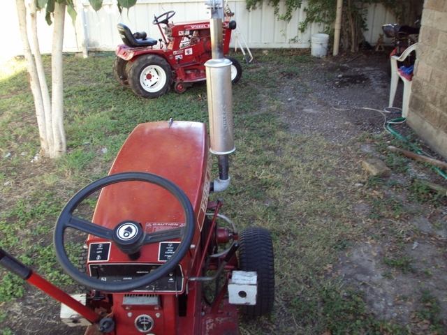

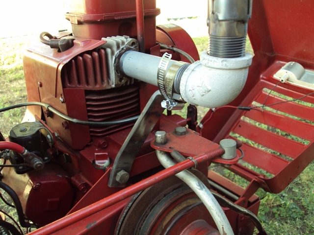

bowtiebutler956 650 #44 Posted October 27, 2013 (edited) Once again, thanks for all the great responses, and that a great looking C-120 you have there ekennell. I got the stack built for it today, although its not done yet. The muffler is only tack welded to the 1" pipe, and the hose clamp won't be staying on there. I will get an exhaust clamp for it, and when its finished, it will get a coat of silver header paint. I also posted a video of it running. As you can probably here, it needs the valves adjusted, and as soon as I find the clearance specs for it, I will adjust them. I love the way this exhaust sounds! I'm really am enjoying working on this beast, and can't wait to start buffing the paint to see if I can make shine! Thanks Matt Here is the Youtube link http://www.youtube.com/watch?v=S78kXv0Elg0&feature=youtu.be Edited October 27, 2013 by bowtiebutler956 3 Share this post Link to post Share on other sites
