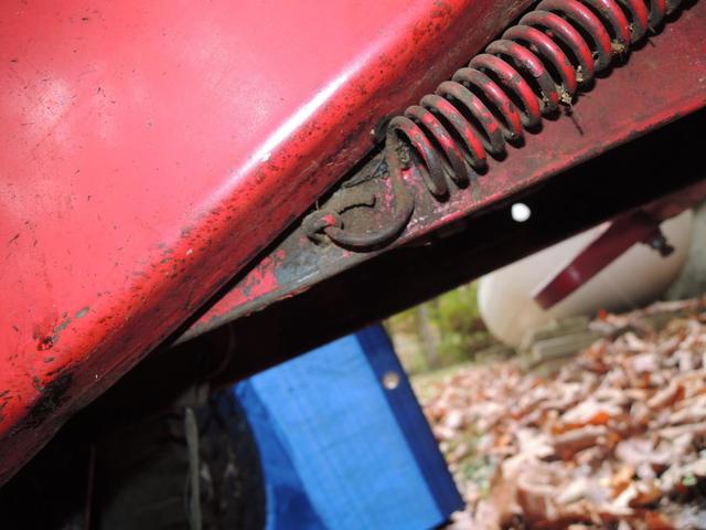

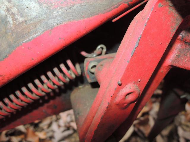

Mr. 856 170 #1 Posted October 22, 2013 well once again the manual doesn't really show how the clutch spring attaches to the frame. there is a cotter pin on one end of my spring. that goes through a hole on the frame? other end attaches to clutch pedal and is kept in place my pulley link arm then a cotter pin? if anybody has some pictures id really appreciate it. almost have a roller. unless something out of my control happens the 856 will be back in action after a 2 year vaca and a much needed overhaul. I cant wait to blow snow with it for the first time. Share this post Link to post Share on other sites

rmaynard 16,719 #3 Posted October 22, 2013 Actually, the spring hooks to a large cotter pin that goes through the hole in the frame, and then the other end hooks to another cotter pin that goes through the shaft of the PTO pedal lock. Share this post Link to post Share on other sites
Mr. 856 170 #4 Posted October 22, 2013 thanks to both of you for your responses. maynard the pictures speak a thousand words. thanks so much!!!! Share this post Link to post Share on other sites
