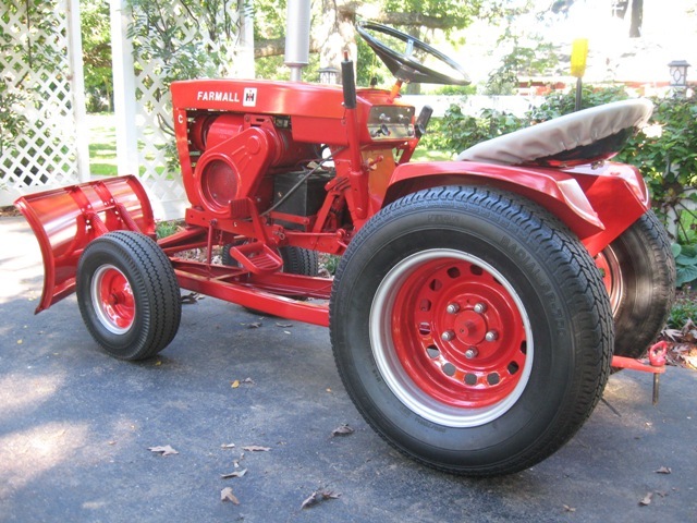

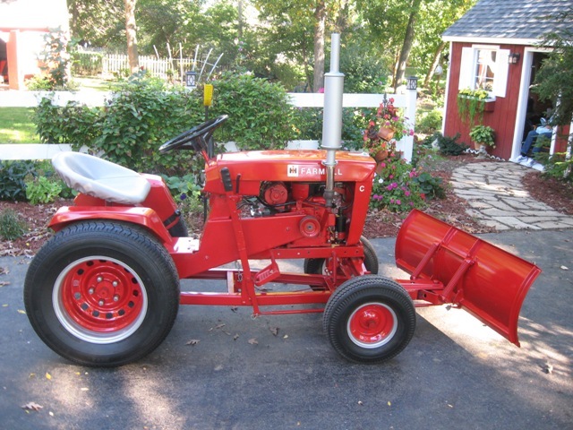

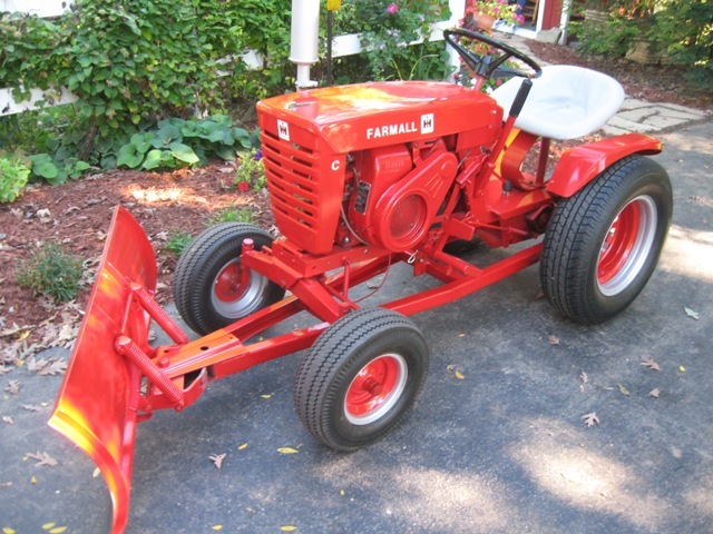

ronhatch 410 #1 Posted October 20, 2013 For some reason while plowing snow last winter, my 8 HP 867 developed a rod knock which forced me to make some decisions. Do I rebuild it or install a 10HP or larger Kohler or maybe even a (dare I say) Honda? I even went so far this past spring as to buy a good running used K241 for a transplant. But after checking out the additional height and not wanting to chop up the hood, I decided to rebuild the original engine using Kohler parts. $450. bucks later, I now have a nice running K181 with a .020" over bore and a .020" under crank. At the same time I decided to lengthen the wheelbase by 5", not only so it will look more like a full size Farmall with a wide front end, but also so I can install a 38" 2 bladed Honda mower deck under it next spring. I never had a deck for this tractor, so I'm hoping the Honda 2 bladed 38" deck will do a really nice job of mowing, plus I picked it up for next to nothing. Please note in the pictures that I added a couple of assist springs to help raise the snow blade. The weight of the blade on the pavement before the springs was 60 lbs, with the springs it was 22lbs. Not only is it easier to raise, but I think the wear plate should last a lot longer. 11 Share this post Link to post Share on other sites

ronhatch 410 #8 Posted October 20, 2013 Thanks for all the complements! Please excuse me, I made a few mistakes on my original post. Me bad! 1. As you all know, it's a 857, not a 867. 2. The rod/crank is only .010" under, not .020". Can it be turned .020" under? I don't know. The rear rims are 14" GM. I don't know what year and model though. I picked them out a pile of rims at a junk yard because they looked a little like the rims that International use on their tractors in the 1960's. The rims are on backward with 2" homemade spacers. I made longer front spindles so the tractor is slightly higher in the front then the back because I like that look. As far as the fenders, I just removed the center section of the original rear pan and added a vertical pieces of steel to the individual fenders. The new seat is mounted to a 'C' shaped piece of spring steel much like the early 110 JD's. It really rides smooth now. For traction; I add about a 100 lbs to the hitch plus, to help steering, I have a couple of gals. of HD windshield washer fluid (good for 20 below) to each front tire. It all works pretty well. The picture was taken a couple of years ago before I lengthen the frame. It shows the weights hanging from the drawbar. 1 Share this post Link to post Share on other sites
