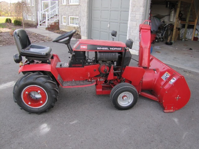

Hydro 131 #8 Posted October 20, 2013 I converted my 97 314H and installed a 520 front end and gear reduction steering along with Matt's motion pedal. The 97 has the smaller steering wheel and I love mowing with it. I just palm the wheel around easily. The only mod I had to make was I shortened the steering wheel shaft and drilled a new hole for the drift pin. That was it. The extra two holes where already in my frame for the 4 bolts that hold the gear reduction part. It was a bit of work but not really difficult. Share this post Link to post Share on other sites
leeave96 495 #9 Posted October 21, 2013 I converted my 97 314H and installed a 520 front end and gear reduction steering along with Matt's motion pedal. The 97 has the smaller steering wheel and I love mowing with it. I just palm the wheel around easily. The only mod I had to make was I shortened the steering wheel shaft and drilled a new hole for the drift pin. That was it. The extra two holes where already in my frame for the 4 bolts that hold the gear reduction part. It was a bit of work but not really difficult. Can you post some pics of this? I've got a 97 314-8, ought to look similar. Thanks! Bill Share this post Link to post Share on other sites
Hydro 131 #10 Posted October 21, 2013 (edited) Not sure exactly what you're wanting to see but here are a three pics Edited October 21, 2013 by Hydro Share this post Link to post Share on other sites
leeave96 495 #11 Posted October 21, 2013 Not sure exactly what you're wanting to see but here are a three pics Nice pics. The heavier front axle and gear reduction must make handling that big snowblower a lot easier. I like the front wheels too! Just wanted to see what the final outcome was in your conversion. So you were able to use the '97 steering wheel too. At first I bought the 520H for a parts tractor, but then drove it off the tractor and was thinking about a repower, since the engine is running on one cylinder (I think - still need to troubleshoot). I was going to put the front axle/steering on my 314-8 and the wider rear tires from the 520H too. Been thinking about this mod - moving steering from the 520H to the 314-8 some and when driving the 520H off the trailer, once again, I was teased with the gear reduction steering. Don't really mind the additional turns to get the reduced effort. My 314-8 is my favorite tractor and I really don't want to mod it, since I bought it new and it is otherwise complete - but... The 314-8 would definately benefit from the steering and rear wheel upgrade. So here are my options I am thinking about: 1. Leave 314-8 as is and fix/repower the 520H 2. Do the steering/rear wheel option and part out the balance of the 520H 3. SWAP the steering from the 520H to the 314-8 and reinstall the 314-8 back into the 520H and swap rear tires. #3 sounds kind of interesting in that, if I fix/repower the engine on the 520H, with the 314-8's front axle and tires, I'd at least have an additional worker. #4 Fix the 520H, find another 520H roller that actually DOES NOT RUN or is MISSING AN ENGINE so I'm not tempted to fix another parts tractor.... So many options - so little time... Bill Share this post Link to post Share on other sites

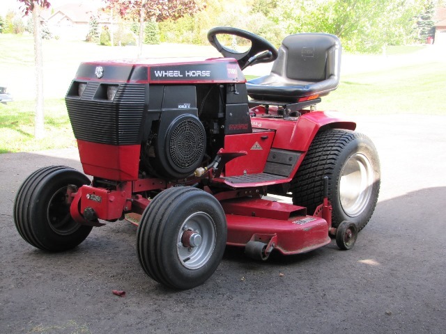

Hydro 131 #12 Posted October 21, 2013 I can't help you there. I had a 520 and a 416, both Onans. I have had a 312, 314 and a 416-8 all Kohlers. You can keep all of the 314 parts you swap out with 520 parts and restore your 314 back to original anytime you want. The only thing you are changing is the lenght of the 520 steering shaft and really you don't have to do that, you can just leave it longer if you want or pick up another shaft to keep original. I like my 314 too and likely at some point I will put the 16 Kohler back in the 416 where it belongs because it is a 1988 the last year they produced the Wheel Horse and used the Magnum 16. The 14 is a smoother and quieter engine but if I had another 520 front end I would put it on my 416 I like it that much. I like really like the wider stance and they turn sharper too. Share this post Link to post Share on other sites
