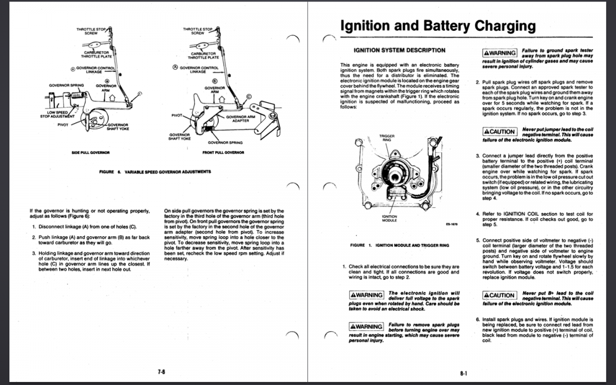

Martin 2,135 #103 Posted December 26, 2013 well i really learned a thing or two about governors today....... Share this post Link to post Share on other sites
Martin 2,135 #104 Posted December 26, 2013 Great videos! Boy, your wife sounds like my wife!!!! do you get beaten much? my wife is terrible...... the abuse i have to put up with....... more videos are on there way....... mike, the choke didn't make any difference any time i tried it and that was my first clue that maybe it wasn't a mixture issue....... the second was the fact that i could steady the governor arm and get it to behave itself..... as far as the belt guide, there is a lower one bolted to the engine plate on 416 #3 that the engine came off, so i will swap that in asap and see what difference it makes, i think i have a idler with a bad bearing as well........ back to the engine....... this hunting crap was really starting to get to me...(actually i was going to type something else, but karl would be on my back) i did a little manual reading, and then went and did some investigating....... in the manual....... so i disconnected the linkage and arm and pushed both toward the carb and they didn't line up with anything. so i disconnected it...... this is the linkage that was on the tractor, when i compared it with the older style thick linkage that mike sent me with the carb and other parts, the bends were all wrong. so i swapped out the arm with the older style and lined up perfectly with the middle hole, stole a clip off the linkage on my t260 sitting in the corner and hooked it up...... then i checked where the sensitivity spring was at. when i put this engine back together i left everything where it was at. the spring had spent some time in the hole it was in as you could see wear in the hole. but according to the manual the baseline was the 3rd hole and not the second one that it was in. so changed it to the 3rd...... then i kicked it in the guts and guess what? 2 Share this post Link to post Share on other sites

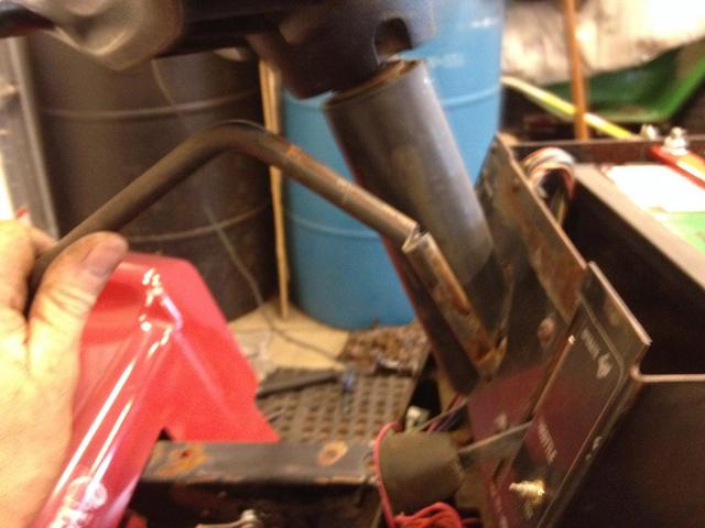

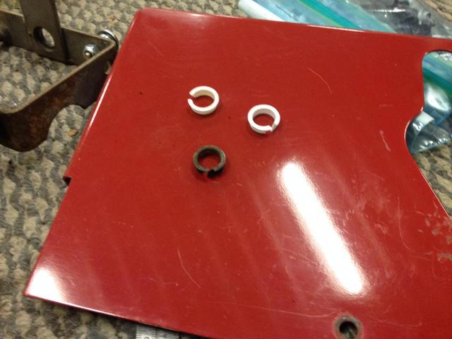

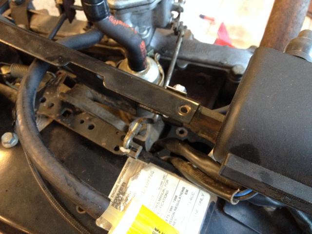

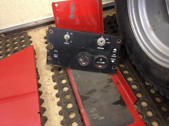

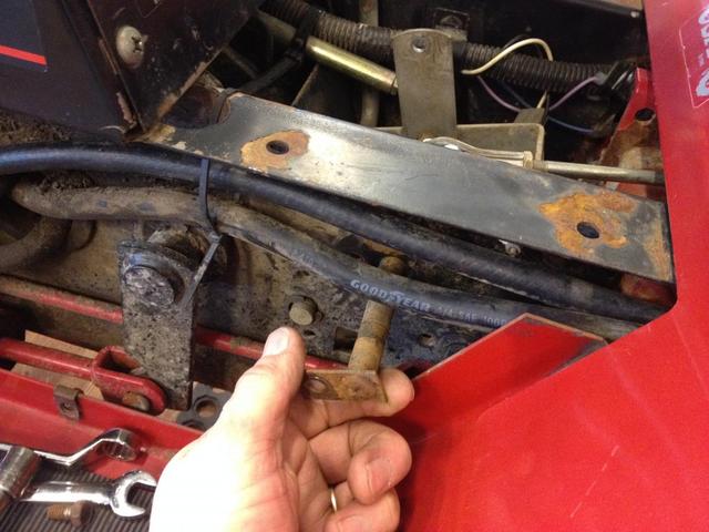

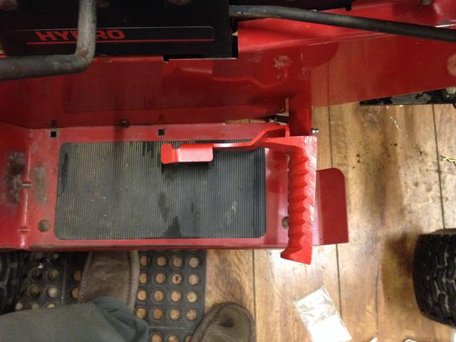

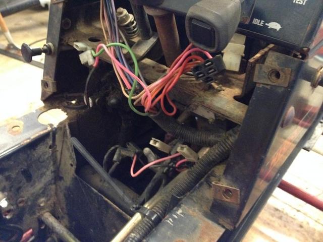

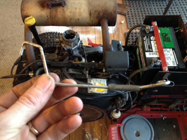

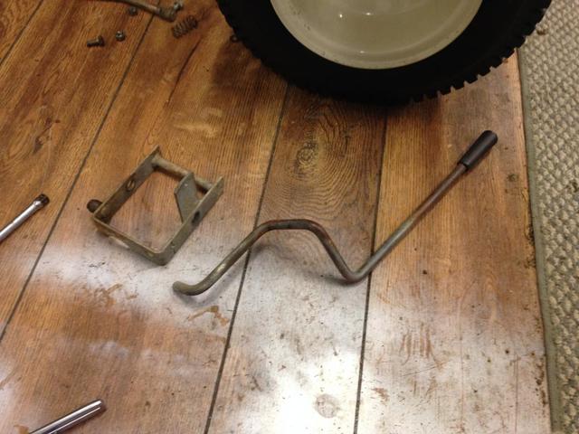

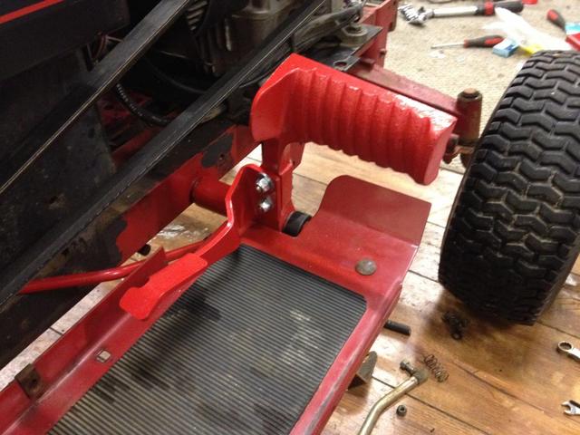

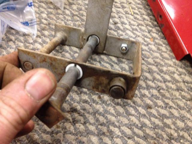

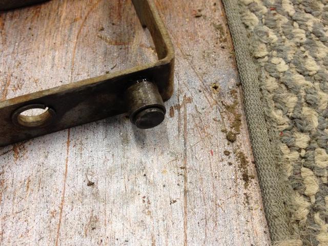

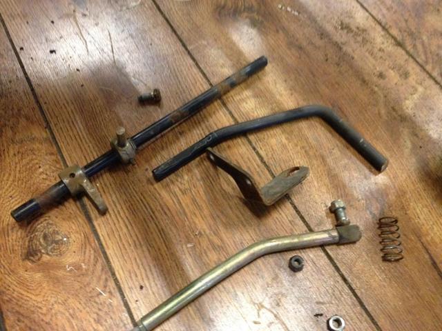

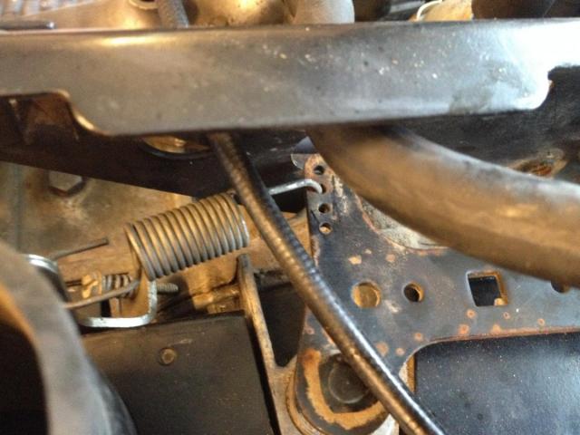

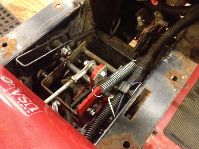

Martin 2,135 #120 Posted December 28, 2013 i worked on installing Matt's foot control this afternoon. got almost done and Jeanine came home so i stopped. we went out to dinner and came home, went to bed early. around 11 pm i decided i didn't want to sleep anymore and went out to work on finishing up the foot control. Matt has put together a very nice kit, one that could possibly be the easiest but most improved upgrade out there. it went in flawlessly...... i followed the instructions he had put together in a pdf.... because this tractor had a temporary side lever control and the column mounted control that was oem on this model, i removed both of them in the process..... heres pics of my install.... first the removal of all necessary parts to be able to install the kit...... had to cut the column lever out as the roll pins in the bottom brackets were a complete pain. if i ever need the lever again i will just weld it back together. all of the column lever parts removed. removed lever from side/floor lever control. the lever isn't needed any more, only need the hydro cam part of the assembly (on the left)...... the return to center roller for the brake side was seized, so this needed to be freed up with some blaster..... i replaced the 2 hydro cam nyliner bushings while this was out. these aren't included in the kit, but mine needed replacing and i usually have them on hand..... part number is 5983 and they cost about $2.00 each. pedal installed rest of parts in kit all in. greased the pedal and other pivot areas and tested the back and forth feel. one thing i changed along the way was to drill the hole for the large spring further to the right of the hood stand so the spring was at a slight angle instead of straight ahead as it was just touching the hydro cam at the straight ahead position when the cam moved from forward to reverse..... one thing i modified from the way it came in the kit was the reverse pedal. i removed it from the main pedal and bent it so that it was further out from the hood stand. the way it bolted up initially was not comfortable for where my foot naturally rests. this is really only my preference and not in any way a problem with the kit. after checking the forward/neutral/reverse and back to neutral adjustment and fine tuning it, the tractor is all ready for a test drive. not now though as its late...... alright dad, you've had your fun out here until 1.30 in the morning working on the scary tractors, lets go inside to bed, ok?? tomorrow (well later today really) will be test drive time. maybe a video as well...... Share this post Link to post Share on other sites

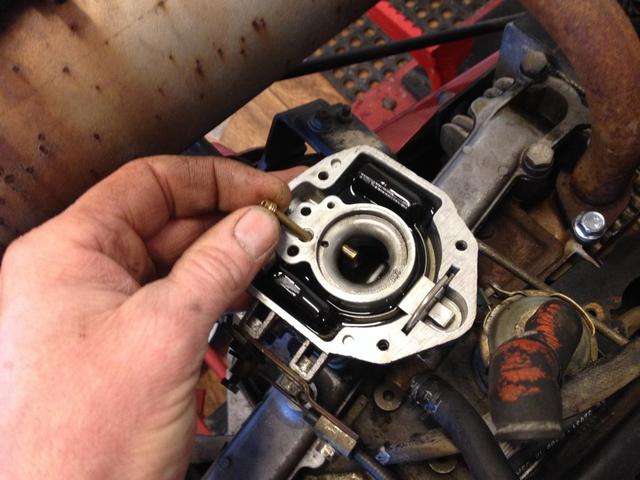

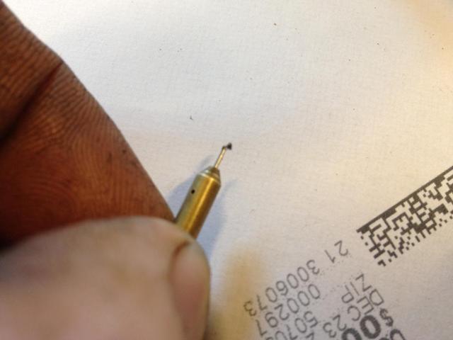

Martin 2,135 #122 Posted December 28, 2013 (edited) heres the foot control video...... at the end of the video the engine started hunting at low to mid rpm, choke helped, so i knew the idle circuit had picked up some more crap from somewhere. must still be some in the carb as i have a filter in the line before the pump and before the carb. pulled the top of the carb and here it is...... i pushed a tip cleaner through the tube and you can see the junk on the end....... eventually it will either clear up or i will get sick of cleaning it out and soak the thing instead..... heres #1 and #2 together, what a happy couple...... Edited December 28, 2013 by Martin 2 Share this post Link to post Share on other sites
