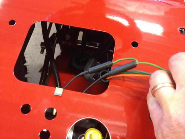

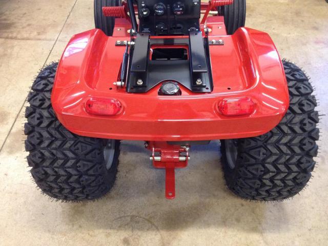

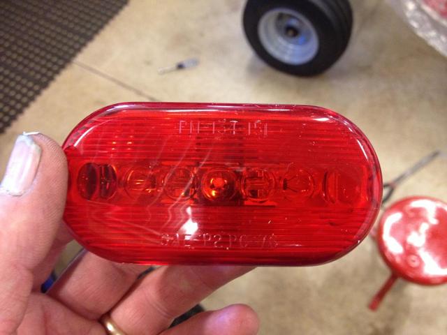

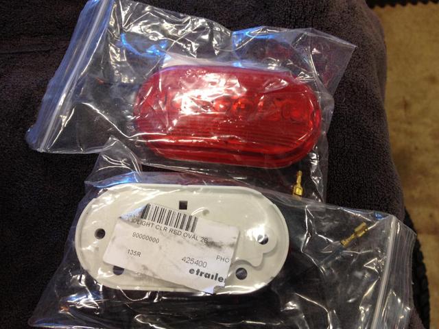

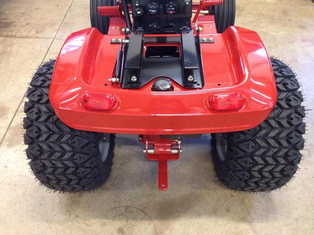

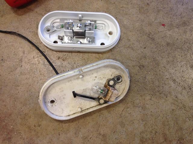

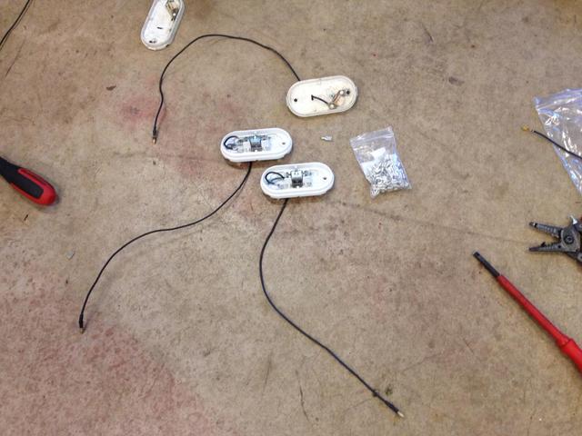

Martin 2,134 #394 Posted June 13, 2014 finally got my peterson tail lights today..... got them fitted with the correct wire and 'bullet' terminal to plug into the factory harness. i had some old taillights that the wire was still good on, but the bulb holder had gone bad, so i cut the wire from two of them, crimped the 3/16 female spade terminal on the end and installed them on the seat pan..... heres the lights i used, peterson 135R clearance lights from trailer.com, they are 2 bulb units and run about $4.50 ea. old tail light next to the new, the old donated the wire to connect them with the correct terminal connected to tractor harness, used one of those clips that like to bite the paint, but seem to hold the excess wiring under the seat pan out of the way of moving parts.... looks like i need to get the steering wheel sorted, i need a seat and then decals. i think I'm almost done!!!!!! 1 Share this post Link to post Share on other sites
