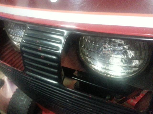

Michael Bullington 5 #1 Posted October 15, 2013 I just purchased some head light bezels for my 310-8 and noticed they do not fit.....after comparing the hood to my 312-8 I noticed the section between the headlights is made different....Did wheel horse produce two hood styles for these models? thanks Share this post Link to post Share on other sites
Kelly 1,033 #2 Posted October 15, 2013 (edited) Should fit, there are right and lefts, and lots of the hoods get bent right between the lights. Edited October 15, 2013 by Kelly Share this post Link to post Share on other sites

Sparky-(Admin) 23,129 #6 Posted October 15, 2013 Hmmm....I thought all bezels were the same from the 1984 Workhorse series right up to the last models to roll off the line. I have to think your hood has been damaged and straightened out some...but not correctly?? Mike.......... 1 Share this post Link to post Share on other sites
AMC RULES 37,196 #7 Posted October 16, 2013 Can you show us a pict of the hood, and bezels you're having a problem with? Share this post Link to post Share on other sites

Michael Bullington 5 #9 Posted October 23, 2013 (edited) thanks for all the replies ....time to get the ole rubber hammer out Edited October 23, 2013 by Michael Bullington Share this post Link to post Share on other sites

Racinbob 11,919 #13 Posted October 23, 2013 It's definitely bent out. The area between the headlighte should be flat. Be gentle and that looks like it will straighten out just fine. Mine was worse than that but in the opposite direction. Looks great now. Share this post Link to post Share on other sites
Racinbob 11,919 #14 Posted October 23, 2013 A good way to straighten it is to sandwich it between two boards and use a c-clamp. That keeps even pressure on it. Share this post Link to post Share on other sites

Wheel-N-It 2,976 #16 Posted October 23, 2013 Yep, the rubber hammer will straighten that right out. Welcome to RS. Share this post Link to post Share on other sites
boovuc 1,090 #17 Posted October 24, 2013 I would bet that someone sat on the front of that tractor hood! Share this post Link to post Share on other sites

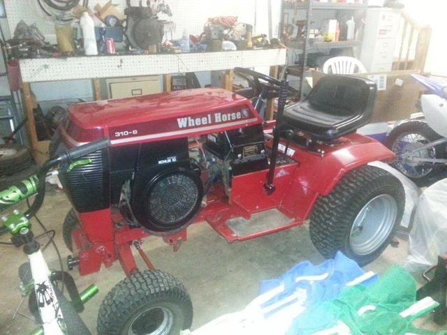

Michael Bullington 5 #19 Posted October 24, 2013 My 310-8---hood repairs complete Share this post Link to post Share on other sites
