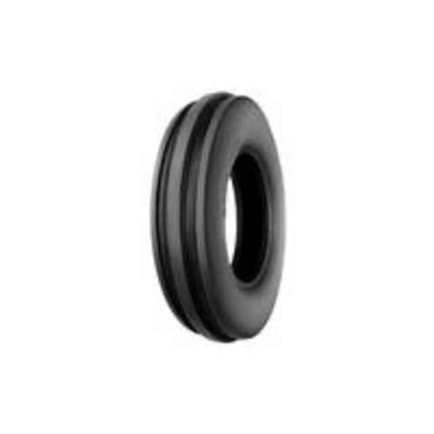

Charlie Smith 142 #1 Posted October 13, 2013 Hello everyone, Yet again, another question for you all, some may be able to help, I am currently looking for some new front tyres for my horse, I am hoping to get some ribed tyres, like those in the picture I'm attaching, however the only horse I have seen them on is Chris's Just 'shakin' I have sent him a PM asking as well, but was wondering if any of you here know where or of a website I can get them from here in the UK. Many thanks Share this post Link to post Share on other sites

Charlie Smith 142 #3 Posted October 13, 2013 So, 4.00-8 I'm not very good at understanding tyre measurements etc, so would they fit my wheel horse front tyres that are 16 x 5.50 x 8 Share this post Link to post Share on other sites
Robins 26 #4 Posted October 13, 2013 Basically, 16 x 5.50 x 8 tyre marking means you have a 16" overall tyre diameter, 5.5" wide, and fits a 8" diameter wheel. A 4.00-8 tyre marking means you have a 4" wide, 4" high side walls, and fits a 8" diameter wheel. So with 4" side walls and 8" rim the maths is 4 + 8 + 4 = 16. So you still have a 16" overall diameter tyre Simply the overall height will be the same as you have already, they will fit your rims, but will be 1.5" narrower but will easily blow out to the rim and look the part Heres a pic i found on the forum aparently with 4.0 tyres on 5.5 wide rims Share this post Link to post Share on other sites
