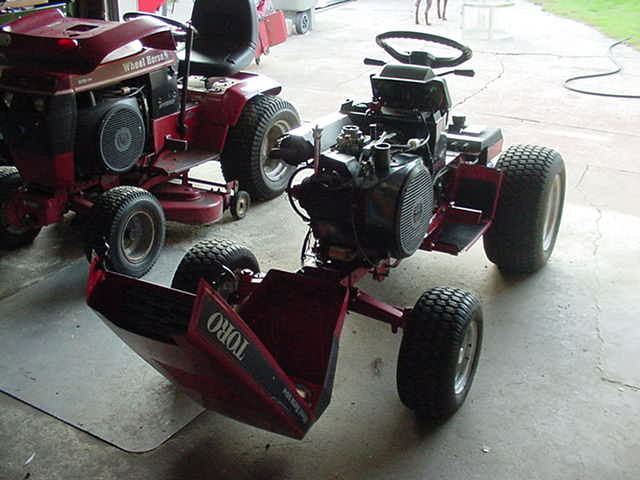

waltsuz 12 #1 Posted October 11, 2013 (edited) Looking for 16x7.50-8 super lug type tires for a 520 front end with "0" luck, hopefully a 6 ply at that. Has anybody come up with an alternative to this. I know I have seen others running front wheel AG tires. I thought of trying a 6.50 but it seems best to see what others have done..Thanks everyone, Walt Here's my future backhoe: I have plans in the mail and I am ready to start cutting? Edited October 11, 2013 by waltsuz Share this post Link to post Share on other sites

waltsuz 12 #9 Posted October 12, 2013 (edited) I honestly did not think about the ribb'ed type tire. Most I have been seeing on the net are the lug tires. The tires on my machine now gotta go, origional from 92" and dry rotted up bad. I know the loader build will pass the 300lb mark and something tuffer seems better. The link Jake just posted look like a good way to go. Another question: Does anyone feel the lift cylinder on this 520 will generate enough down pressure for a grader blade on the rear. I have a lot of wonderments in my head I may continue to ask about with this project. I am also considering a turning cylinder for the blade. I hope I don't clutter this site with what seems nonsence and everyone so far has been really good with the help. I love projects like this and this to me is going to be really cool. Thanks, Walt Edited October 12, 2013 by waltsuz Share this post Link to post Share on other sites
