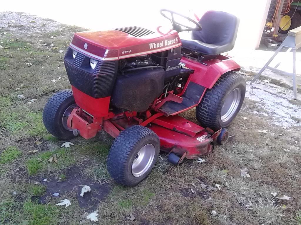

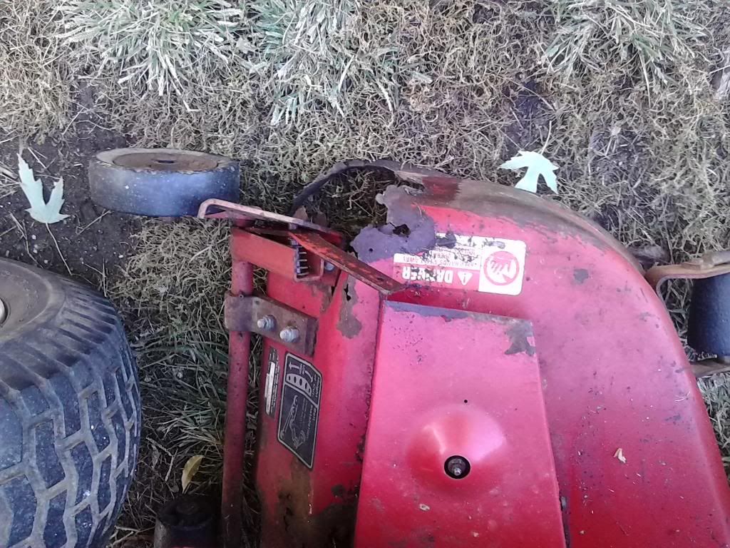

flyovrcntry 115 #9 Posted October 20, 2013 Got a couple pics of my tractor http://i1205.photobucket.com/albums/bb422/flyovrcntry/IMG_20131019_124752.jpg http://i1205.photobucket.com/albums/bb422/flyovrcntry/IMG_20131019_124815-1.jpg As you can see in the second pic the tires arerounded,like they have too much air.When I checked the pressure it was only 5 lbs.What I found is there is tubes in all the tires,and the tubes in the back are too small I beleive.The reason I say that is,when I took the core out the stem went inside and I had to use long thin needle nose pliers to get it back.I'm thinking of just taking the tubes ou and installing stems.I dont think the tires can be that bad,at least nothing visible.I'm just thinking the tube is so small it is just pushing up in the middle of the tire. But anyway, I sure like this tractor.I have about 400. in it as it stands. I replaced a hose on the lift control that had been leaking for a long time.The oil caused dirt and grass to accumulate in the console area,and om the transaxle. The 42" deck is rough,I am going to attempt a repair.I am not experienced at cutting and shaping the metal,but I am going to give it a go. My primary reason for getting this tractor was to install a dozer blade,and I bought a 42" blade and bracket today for 125. The ground spee of this tractor really surprised me,almost makes me think someone changed the pulley.I'm going to check and see if the belt is the standard size. http://i1205.photobucket.com/albums/bb422/flyovrcntry/IMG_20131019_124826.jpg Share this post Link to post Share on other sites
Wheel-N-It 2,976 #10 Posted October 20, 2013 Hey, you got a nice one there! Only $400 in it so far is really good. There is no screen on the hydro fan, and the louvers in the hood tell you its a 1986 model. The '85s had a smooth hood. How many hours are on the meter??? By the way, I was mowing with my 417A today and got stung on the lower lip by a hornet. OUCH!!! Share this post Link to post Share on other sites
