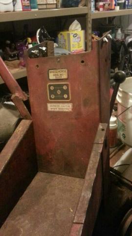

sparky6398 2 #6 Posted October 10, 2013 Jason, Thank you. Do you know where they are on a 701? Share this post Link to post Share on other sites
CasualObserver 3,417 #7 Posted October 10, 2013 Yes, under the dash on the tower. Above the shift decal. Via Tapatalk 4 Share this post Link to post Share on other sites

CasualObserver 3,417 #9 Posted October 10, 2013 No problem. I should add, that with exception of the RJ-58 only the serial numbers were on the tag. They didn't put model numbers on again until 1965 when they switched from decals to the black and silver aluminum tags. Via Tapatalk 4 1 Share this post Link to post Share on other sites
