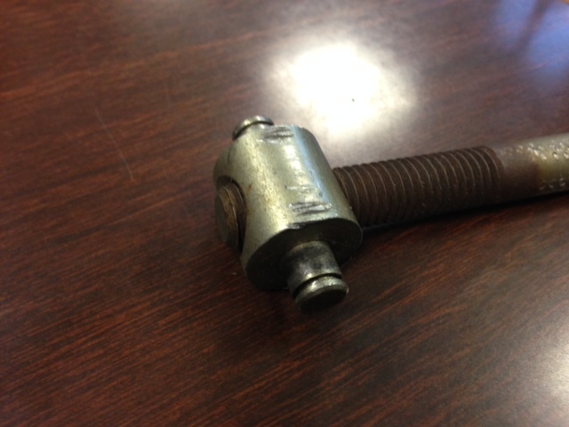

wp205a 43 #8 Posted April 29, 2014 He cut the new belt, got the adjuster off, brought it to me. I sili kroiled it, put in a big vice, got it moving with a 12" pipe wrench, it froze in place, and would not budge. Heat might have freed it up, but he got a new one and all is well. Share this post Link to post Share on other sites

wp205a 43 #11 Posted April 30, 2014 That's as far as it'd go. Stopped dead. Share this post Link to post Share on other sites
