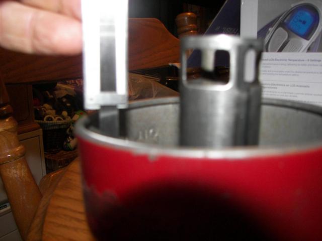

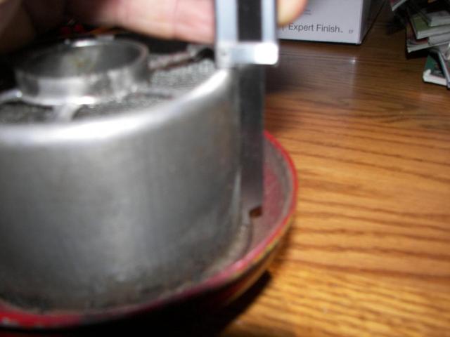

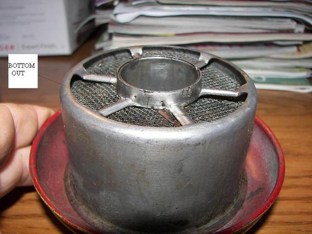

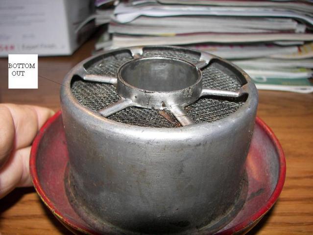

buckrancher 2,696 #26 Posted December 29, 2013 (edited) I think your setting on the flat ledge in the cup I checked height between the two parts I think your bottoming out on the top cover on the flat in the lower cup where the fliter screen is Brian Edited December 29, 2013 by buckrancher Share this post Link to post Share on other sites
AMC RULES 37,256 #27 Posted December 29, 2013 Either way...this modification worked... the oil bath is full, and the engine is running fine. 1 Share this post Link to post Share on other sites

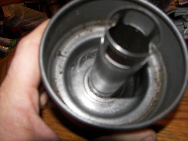

buckrancher 2,696 #28 Posted December 29, 2013 if you ever make another one just don't drill the hole as big in the top cover so the pipe does not come thru it Brian 1 Share this post Link to post Share on other sites
AMC RULES 37,256 #29 Posted December 29, 2013 Agreed, that's the ticket here. I had to take the chance though, and figure it out as I went...as I had no reference on hand to work from. Suppose I could tack in a couple fender washers to the underside of the lid to prevent this tube from coming up through the cap. Next one will be even better...now that I know. Thanks again for your help Brian. 2 Share this post Link to post Share on other sites
buckrancher 2,696 #30 Posted December 29, 2013 I'm going to do the red one I took pictures of going to put a 1 1/8" dia. hole in top cover and spot weld a 1 3/16" freeze plug in the bottom cup I will post some pictures when I get it done Brian 2 Share this post Link to post Share on other sites
AMC RULES 37,256 #31 Posted December 29, 2013 Awesome, I'm sitting on a pile of 'em over here. Share this post Link to post Share on other sites

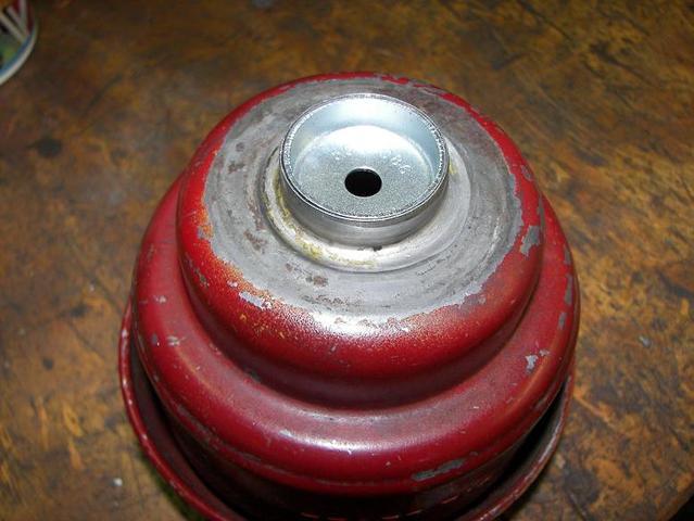

buckrancher 2,696 #32 Posted January 6, 2014 Heres my downdraft to updraft air cleaner conversion top has 1 1/8" dia hole Bottom has a 1 3/16" freeze plug (Dorman #555-086) with 9/32" dia hole on center freeze plug is a light press fit in air tube Brian 3 Share this post Link to post Share on other sites
