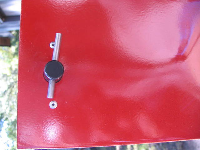

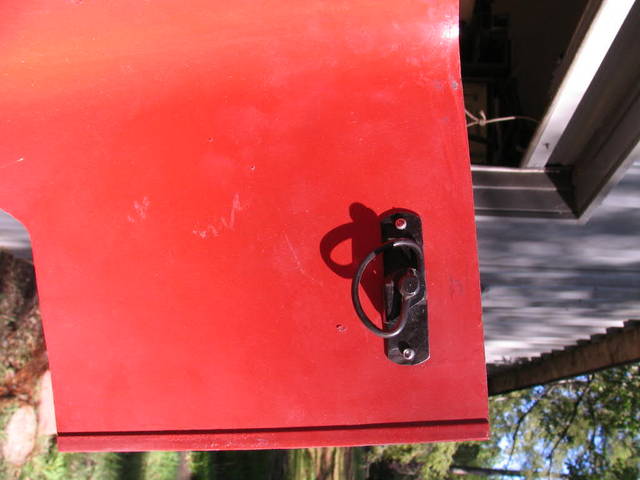

pacer 3,177 #7 Posted September 21, 2013 (edited) Was taking a few pics this morn and thought of your request on the hood latches - hope this is what you need. They are on my 1975 D-180, I recently done some painting on it and removed them for that, re-installed with pop rivets. The 2 sides will be installed in 'mirror' fashion, the pics are shown in the 'open' position on the right side of the hood. Edited September 21, 2013 by pacer Share this post Link to post Share on other sites

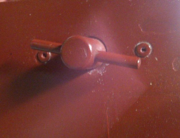

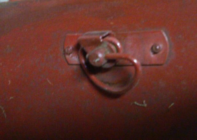

Trouty56 567 #8 Posted September 21, 2013 (edited) OK. Here is what I have too...maybe the both will help..... The inside is on the right side....back of the hood to the top....outside is the left side.....they both latch clockwise from whatever side you stand on... Edited September 21, 2013 by Trouty56 Share this post Link to post Share on other sites
Marv 982 #9 Posted September 21, 2013 Bob and Pacer, Thank you very very much for the pictures. Using both I was able to remount the latches. Marvin Share this post Link to post Share on other sites
