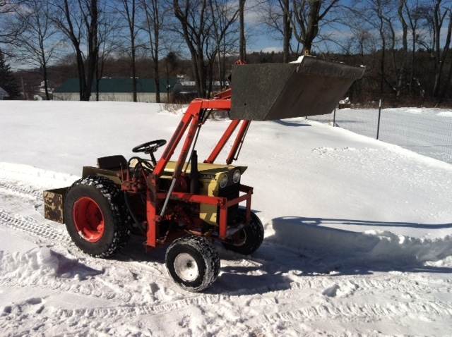

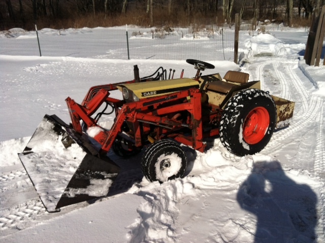

tomtractor 71 #78 Posted March 26, 2014 Here is my 1966 Case 190 with Johnson loader. I am waiting for Spring to tune-up and use this tractor. 2 Share this post Link to post Share on other sites

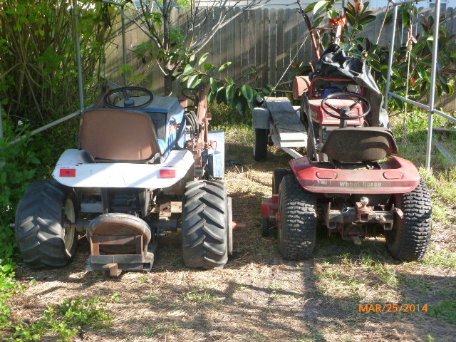

over60pirate 24 #80 Posted March 26, 2014 A word of caution. Be careful moving the tractor, with the loaded bucket raised very high. With the narrow, standard, track width, and a high loaded bucket, tipping over, when hitting a pot hole, etc. can be dangerous. For this reason, the po of my loader GT, installed rear wheels with a wide offset. In the pic below, my WH 414-8 on the right has a 36" track width, and the Ford LGT 165/loader, with wide offset wheels, has a 49" track. Share this post Link to post Share on other sites

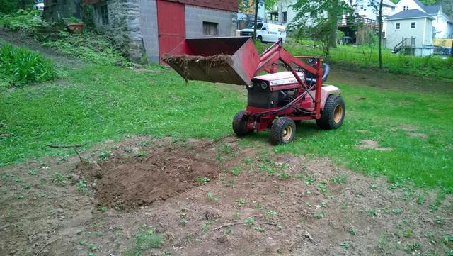

stratostar250 934 #91 Posted May 15, 2014 (edited) I've done very little with it so far, but I am positive that it needs weight in the rear. I'll figure something out, though! Here, I was just trying to see how she digs and moves and such. She's still new to me, so I'm slowly figuring everything out Edited May 15, 2014 by stratostar250 Share this post Link to post Share on other sites

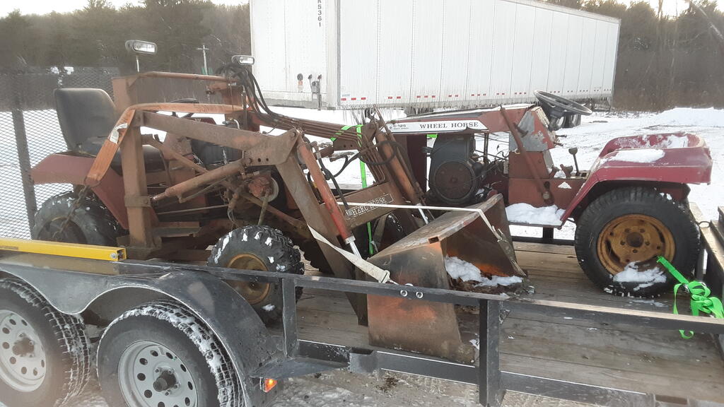

wh315-8 595 #97 Posted January 12, 2022 Old thread but never too late to add to. 1980 ARK on a 1981 C145 Blackhood. 1 1 Share this post Link to post Share on other sites
