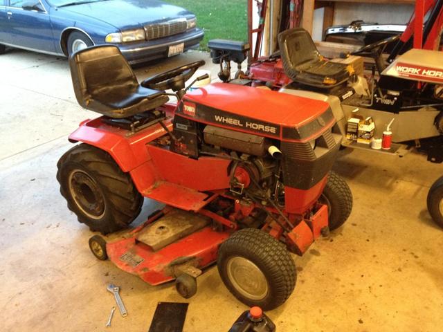

sorekiwi 761 #28 Posted October 6, 2013 and I'm glad you got it squared away. Matt Well I hope it is squared away, time will tell if the motor lasts or not. It was not my intention to do a "build thread" on this tractor, but I thought I'd show a few pics of what I have done in case anyone needs some ideas. I ditched the (diesel) gas tank and went with the stock WH tank under the seat. I used a small electric pump to feed the motor. This allowed me to use a Cub Cadet muffler across the front of the motor. Kept it simple, a 90 deg. bend out of the motor to the muffler. I may do something with the tip of this muffler when I work out how bad the smoke is and where it goes. I think it gives a nice clean look to the right side of the tractor: The aircleaner didn't clear the hood on the left side, so I made a small elbow to lower it. It works but I don't like it so this will change. I want the same clean look on the left side so I need to work out how to tuck it back under the hood. Even considering notching out the side of the hood to clear it in the stock location ! Still need to hook up a throttle cable. I have been trying to buy a cable ready set up that comes on most of these motors, but it seems that none of the vendors want my business as they aren't replying to my emails. Almost there..... 1 Share this post Link to post Share on other sites
AMC RULES 37,255 #29 Posted October 6, 2013 Wondering Kiwi, if that is that a louvered hood... any way to attach the air cleaner to the inside bottom of the hood? Separates from the engine when you lift the hood. Share this post Link to post Share on other sites
sorekiwi 761 #30 Posted October 6, 2013 No Craig the 516 had the plain old non-louvred hood. Maybe I should just cut a hole and poke a big trumpet through it!! 1 Share this post Link to post Share on other sites
sorekiwi 761 #31 Posted October 12, 2013 I mowed a little with the diesel tonight. I used the same 48" deck that I have used all summer on my 520H. The diesel doesn't have the power of the (20hp) Onan, and is probably down on outright power compared to a single 16 hp Kohler as well. But it does have torque. When you hit a thick patch of grass the Onan would bog down a little. The diesel slows slightly and starts to belch smoke, but does power right through. I only have about 3 hours run time on the motor now, so it probably needs a bit more to break in properly. And I think I need to play a little with the "smoke screw". From what I have read, when these engines are set up correctly they will belch black smoke under acceleration, but shouldn't so much under heavy load. Noisy SOB though. And doesn't have that Onan growl, or play the sweet songs of a single cylinder Kohler bouncing of its governor. Maybe it will quieten down a little as the muffler carbons up a bit. Share this post Link to post Share on other sites

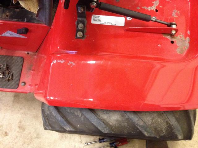

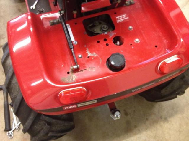

sorekiwi 761 #41 Posted November 3, 2013 alright you've got it going, now you need to get it shining....... Is that Ari on the tractor Mike? if it is she's really growing up, the teenage years look like they are upon you now, have fun!!!!!!! Yeah, my baby girl is growing up way too fast. She deals with the hydro tractors a lot better than the Lawn Ranger, she still gets spooked by the wheel stands! I hate shiny tractors these days, every scratch in new paint bugs me. But this one has a ton of bubbly paint, so I'm gonna have to do something. The belt guard, footrests and dash tower have all been rattle canned as I've been working on the tractor. She's no beauty queen, but come closing time she looks pretty damn good! 1 Share this post Link to post Share on other sites
Martin 2,133 #42 Posted November 3, 2013 yeah, the shiny tractor thing is hard when you find the scratches etc. the powder i use is much more robust than the rattle cans so i don't worry too much, but they still scratch when people put their fingers in your dust covered paint....... I'm starting to like buffing the old weathered paint and just putting up with the scratches and minor defects. still looks good from a distance and nice and shiny..... of course the paint needs to be savable in the first place. the original stuff is much easier to revive than newer rattle can. you might find it will come up better with some of that new zealand elbow grease..... Share this post Link to post Share on other sites
sorekiwi 761 #43 Posted November 3, 2013 I'm starting to like buffing the old weathered paint and just putting up with the scratches and minor defects. still looks good from a distance and nice and shiny..... of course the paint needs to be savable in the first place. the original stuff is much easier to revive than newer rattle can. you might find it will come up better with some of that new zealand elbow grease..... I know what you are saying Martin. I am a fan of original paint if its in good enough condition. My '73 14 Auto still has really nice factory paint, and a little wax does wonders. Is it powder that is on the later tractors? Whatever it is it doesn't stick as good as whatever they used on the 70's era tractors. I think this will take a little more than a quick buff up: Share this post Link to post Share on other sites
Martin 2,133 #44 Posted November 3, 2013 (edited) well it might take a little more than a quick job, but i think you could get that looking reasonable....... the missing paint would still be missing, but that weathered red should come up similar to this. hard to see from this pic but the paint was dull, took more than a hand buffing, was wearing me out big time, so i used a small da polisher drill attachment from meguairs and their compounding liquid. well worth the effort. i thing the battle scars need to stay as it gives some 'character'....... how it looks now....... the polisher didn't turn the crappy looking deck into a nice snow plow, its good but its not that good.......... the gt1848 is getting the same treatment, its the metallic though and isn't coming up as good as the solid red. still will make the tractor look a little fresher..... oh, i forgot to mention that I'm almost positive they used powder on these later ones. thing is the powder isn't to blame for the peeling, its all in the surface prep. a lot of the stuff we do for customers that don't want to pay for surface prep will look exactly the same in 20 years or so. enough hijacking your thread already, sorry..... Edited November 3, 2013 by Martin 1 1 Share this post Link to post Share on other sites
