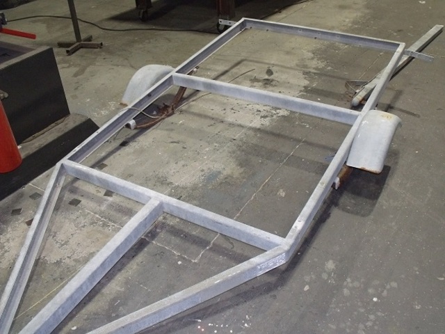

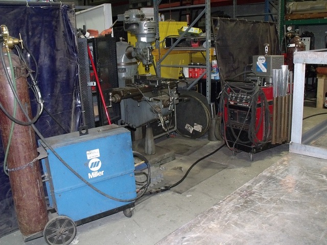

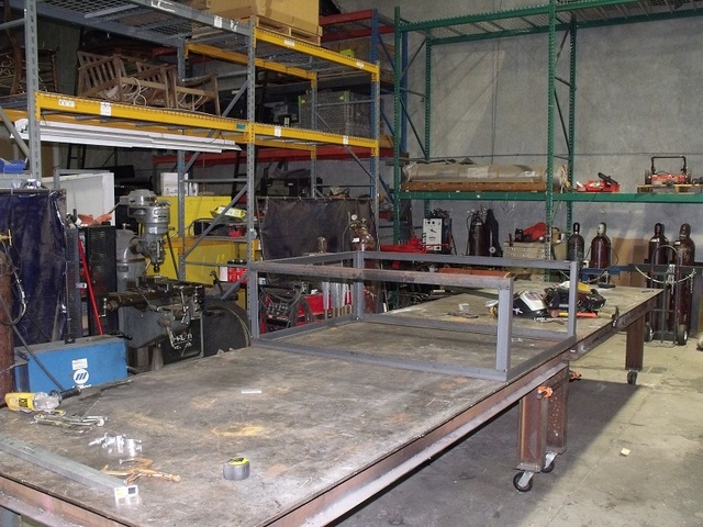

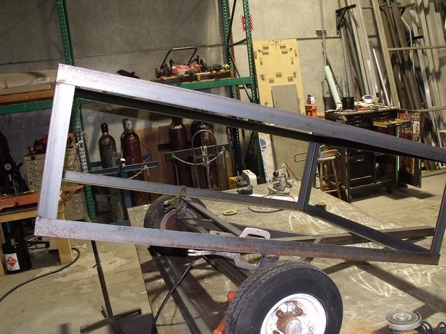

Sycoticca 37 #1 Posted August 27, 2013 I am starting on a build of a trailer. Dump style, haven't figured out if I want to go leaf spring or hard mount axle. but any way here is the start. I figured leaf spring so when I take the kids for a ride it's nice and soft instead of bouncing around. 42" x 60" is the size, I plan on using 13" wheels on 1" taperd bearing hubs, 4 or 5 lug (I have both). ah the tools of destruction 2 Share this post Link to post Share on other sites
KC9KAS 4,746 #3 Posted August 27, 2013 Looks like the start of a nice trailer. Thanks for the photos, and keep us posted with the progress. Yes, nice shop...Is that at your home, or at your "work-place"? Share this post Link to post Share on other sites

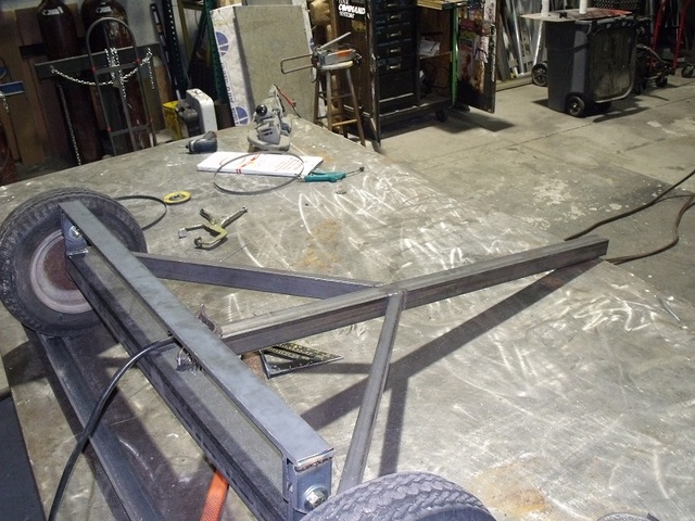

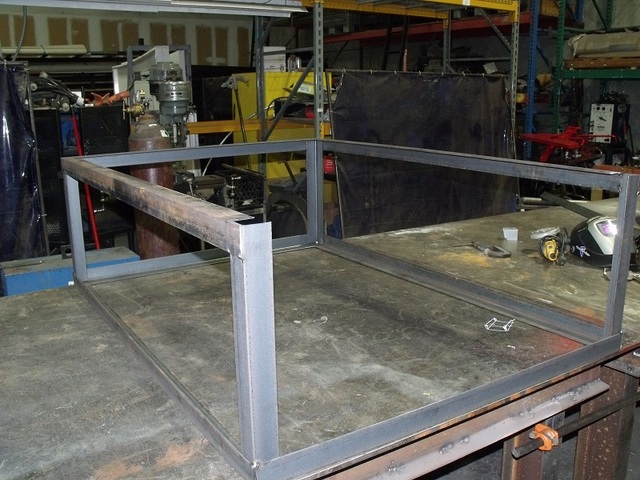

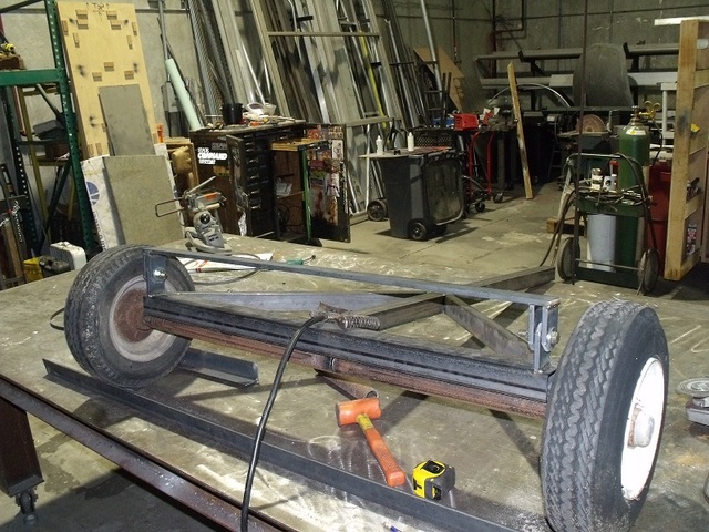

Sycoticca 37 #4 Posted August 27, 2013 (edited) It is my work place. I mean home......... well I am their a whole bunch anyway. Just a short 20 years...20 long years..It is nice having all the right tools at hand. May as well be my home. I run a Scenic shop so I have all the good wood tools also. Here is the progress after a total of 2 hrs time : Edited August 27, 2013 by Sycoticca Share this post Link to post Share on other sites

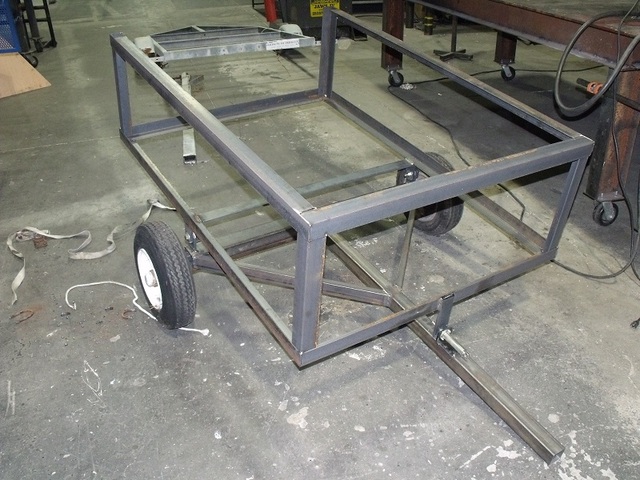

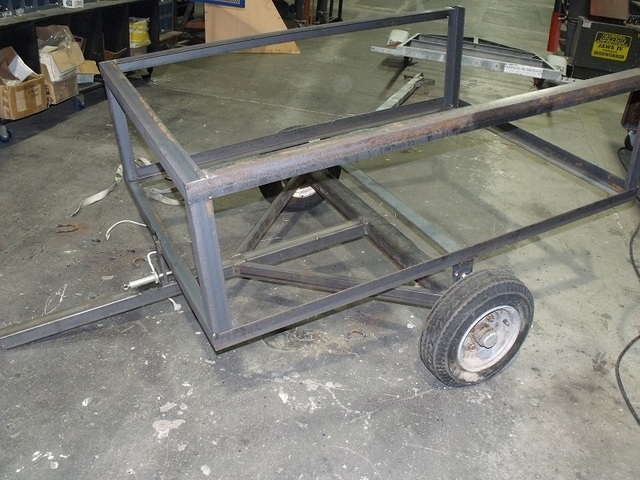

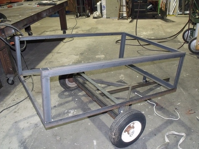

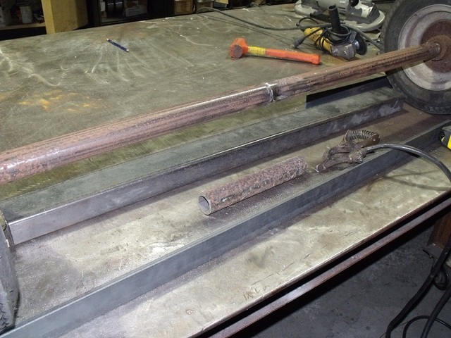

Sycoticca 37 #5 Posted August 27, 2013 Donor boat trailer axle. Decided to go non-leaf spring. I figured if I used the leaf springs it would put the pivot point to far from where I wanted it. Sectioned the axle 10 inches and presto just what I needed. I will be using larger wheels and tires on it. Share this post Link to post Share on other sites

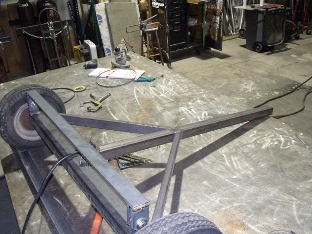

Sycoticca 37 #6 Posted August 27, 2013 It will get a standard 2" ball hitch mounted on it. For that I will fab a new hitch for the tractor to convert the orig. into a Standard 2" receiver. I move my boats around all the time so if I make every thing the same it would be a lot easier. I can just pull the ball off my truck and slide it into the receiver on the tractor... 2 Share this post Link to post Share on other sites

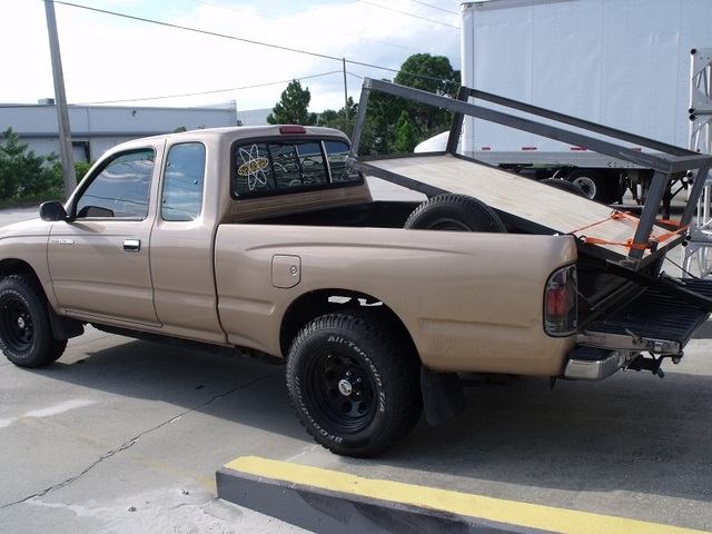

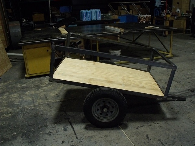

Sycoticca 37 #11 Posted August 29, 2013 (edited) All welded up and on the truck to go home for some paint. larger wheels and tires are on also. Don't think I am going to use the ply on the floor thinking I may just stick with some oak planks and seal them real good. We have a supplier down here I can get red oak rough sawn 1"thick x 8" wide for 2$/foot. If I need to I can plane it down thinner ... I am still thinking Mahogany, that's 6$/foot...good thing I don't need that much.. same size rough as well. The mahogany will not dry out and rot like the oak and it looks way better stained and cleared. Edited August 29, 2013 by Sycoticca Share this post Link to post Share on other sites

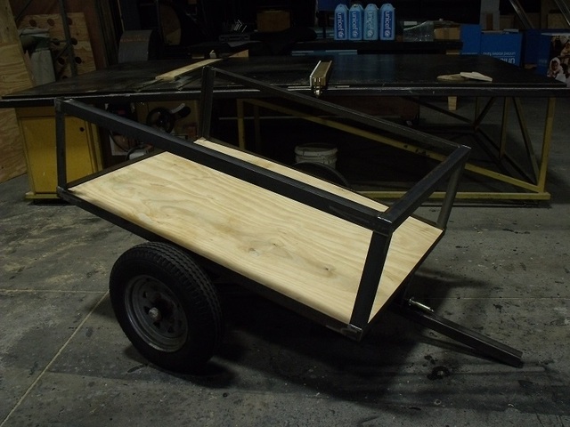

Sycoticca 37 #14 Posted August 31, 2013 (edited) ok here we go... Woke up this morning with a pile of raw wood in my truck that needed to be sealed. Just need to pick up 2" hitch and done.. Decided to go with Maple Ply stained and cleared all sides at this time until I get the cash to go buy the rough Mahogany...I still think it looks damn good.. Edited August 31, 2013 by Sycoticca 3 Share this post Link to post Share on other sites

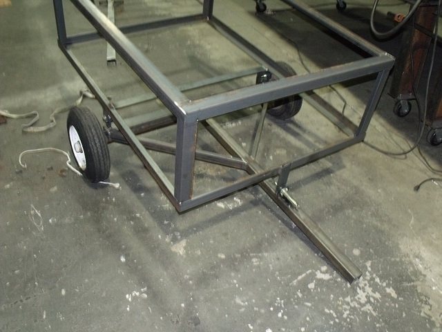

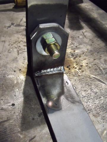

Alan_Heist 7 #16 Posted August 31, 2013 Where did you adapt that latch from? Looks sturdy. That thing will last you for years!! Share this post Link to post Share on other sites

Sycoticca 37 #18 Posted August 31, 2013 The lock pin is one we use on Broadway show scenery for locking moving wagons on stage. I was actually looking into electric dump but we will see. As for Hydro, can it be run off the pump from an Electro 12? and the tree.... its a Mulberry, its going in the ground this weekend Share this post Link to post Share on other sites
