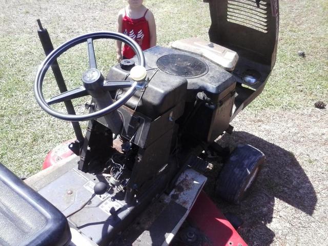

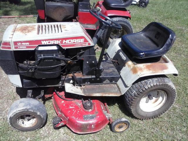

BretzFamily 1 #1 Posted August 23, 2013 Well as my last questions and things worked well and my Wheelhorse 417a runs better then ever. My mule drive keeps eating belts for the deck so its just my trailer puller. Well my real question is I just gotten a Workhorse lt1600 with a mowing deck. What is the good and bad about this kind of model. I. read on here about the gt being horizontal so the lt must be vertical. it cost me 200 in labor i bartered for it. rebuilt 5 engines with customer provide parts and gave.him a troy bilt self propelled with back deck and a 12.5 i rebuit without spending any money. But anyways what you guys think. Share this post Link to post Share on other sites

BretzFamily 1 #11 Posted August 28, 2013 Well it looks the same as i have it. tried it looks good will mow my grass this weekend will let you guys.know what happens. yeah i never turned back soon as i got it for free. my wife bout cut my head off when.someone offered 600 an i almost took it. I have a couple questions about the Workhorse lt1600 Ok from my understanding its a 16 hp vertical shaft that came with.no deck or nothing. the side discharge was bought after thought. First question is the deck worth more then the tractor. or is it better to sell whole. Seen the gt models has.problems with the.whole vertical pto clutch and the briggs not being able to handle it. I could not find.much of anything for the lt models. so not to sure about much. i went.through abd made it run right does idle and.run well at full tilt. bad ignition though have all parts. also before and after i changed the oil when i start and run this machine i smell cologne like musk. the oil was concentrated with it before and.now after there is still a scent of it. never came across.anything like it so any thoughts? also i have a rear discharge for.my 417 could i modify my lt side discharge deck for use on my 417 . i eyed it up but does not look it any thoughts on that i enclosed pictures of the lt1600 Share this post Link to post Share on other sites

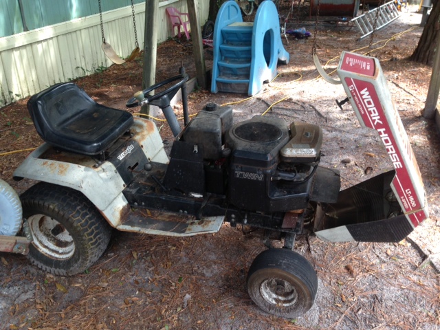

BretzFamily 1 #13 Posted September 8, 2013 Well the 417 cuts the same no chewing of belts yet whicch is good. the lt 1600 went up to some dad and his kid in leland/bellville. his son redid a c series and his dad had one also. so they got a.steal at 125 to redo the lt1600. Got a damn steal. all i say is good luck to them. i got a line.on.another. yeah i am getting an 18 twin here soon. they run hard for being older. Share this post Link to post Share on other sites
