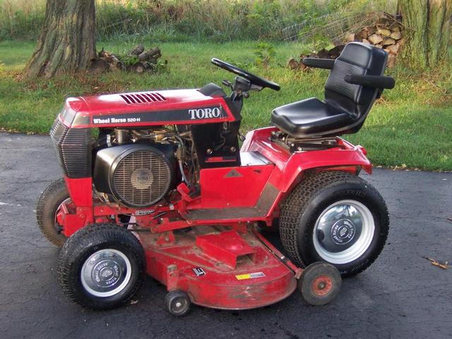

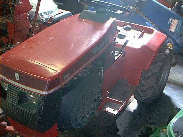

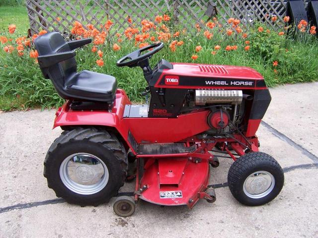

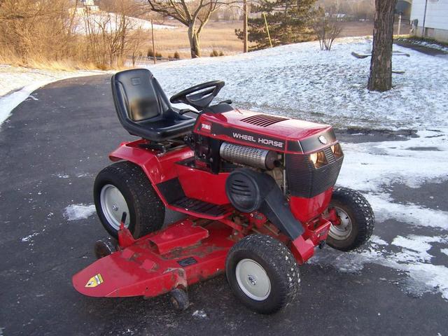

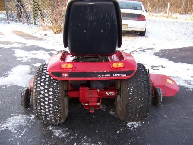

wh5208speed 677 #6 Posted August 24, 2013 There is no differences between the 1992 & 1993 models. 1988-89 (Photo 1)Two 520 Models - 520-H was regular axle and the motion lever was between the legs. 520-HC was a forward swept axle with no gear reduction steering. Both models had Stewart Warner gauges, hydraulic lift opposite side of the PTO lever, and seat had a four bolt armrest backing. Chrome Hub Caps 1990- (Photo 2) Two models 520-H and 520-8. Switched to Toro decals with red letters, Stewart Warner gauges, hydro motion lever and hydraulic lift now on the steering column, seat has 4 bolt armrest kit, forward swept axle (all 520's from 1990-97 had forward swept axle). Chrome Hub Caps 1991 520-H moved to "Toro" branded gauges, gear reduction steering, same 4 bolt seat armrest kit. Chrome Hub Caps 1992-93 (Photo 3) 520-H New decals with "Wheel Horse 520-H" in White. New seat backing (same padding) with 6 bolt armrest kit. New re-enforced shift plate cover to address cracked mounts where the seat pan and seat put stress (All 520's 1992-97 had this plate). Chrome Hub Caps 1994-95 (Photo 4) 520-H New decals with Just "Wheel Horse" in bigger white letters on the hood and the "520-H" was moved down to the side of the dash tower. Chrome Wheel Horse logo on front of the hood. 1996 (Photo 5) 520-H New decals with 50th anniversary "Gold" lettering, Gold Wheel Horse badge on the front, grey hubcaps with Gold Wheel Horse logo on front of hood, New foot rests with narrower design and thinker rubber foot padding, new grippy steering wheel, bigger handle on the PTO lever, bigger brake pedal, new "Toro" embossed seat with 6 bolt armrest kit, motion and hydraulic lift levers get bigger handles, PTO cover 1997 520-H New decals with "Silver" lettering, Chrome Wheel Horse badge on the front of hood, grey hubcaps with Chrome Wheel Horse logo, New foot rests with narrower design and thinker rubber foot padding, new grippy steering wheel, bigger handle on the PTO lever, bigger brake pedal, new "Toro" embossed seat with 6 bolt armrest kit, motion and hydraulic lift levers get bigger handles, PTO cover. One small detail is in 1997, all of the axle hubs where painted black....all earlier models where red. Thad (Ohio) 3 1 Share this post Link to post Share on other sites

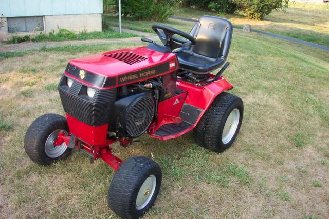

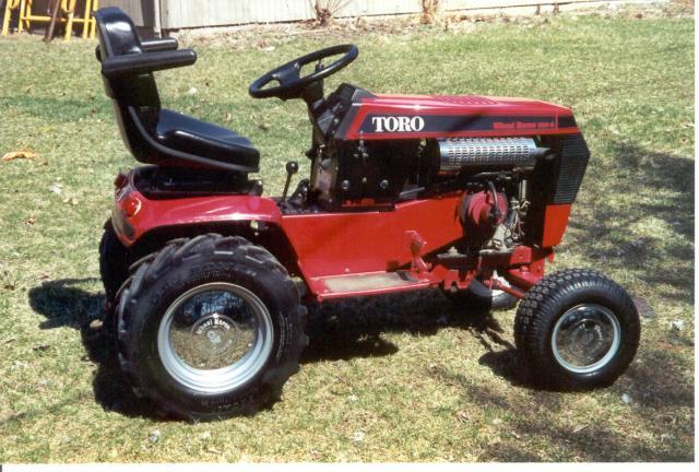

wh5208speed 677 #7 Posted August 24, 2013 Here is the photos of the 1997 year....ran out of 1MG space on the last reply. You can see the 1997 black axle hubs in the 2nd photo. Thad (Ohio) Share this post Link to post Share on other sites
