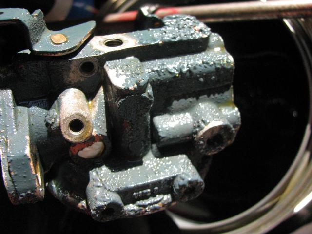

AMC RULES 37,250 #15 Posted August 23, 2013 As it went into it's bath tonight. Share this post Link to post Share on other sites
squonk 44,904 #16 Posted August 23, 2013 While in the bath, be careful feeling around for the rubber ducky! Brian is right. The stuff today is glorified toilet bowl cleaner. I got a can last fall. I can get it on me and my wife won't notice it. The old Berrymans, Mac's (Napa) stuff if I even looked at a can she knew. We used to have Safety Clean carb cleaner in the shop. A 15 gal drum with an agitator (Not ME! ) on top. You could clean the hair off a Wombat with the stuff. Once I had one of those Computer Command Quadrajets in it and one of the tiny mixture needles got out of the basket and fell to the bottom. I had to go fishin. My arm looked like a lobster for a week! 1 Share this post Link to post Share on other sites

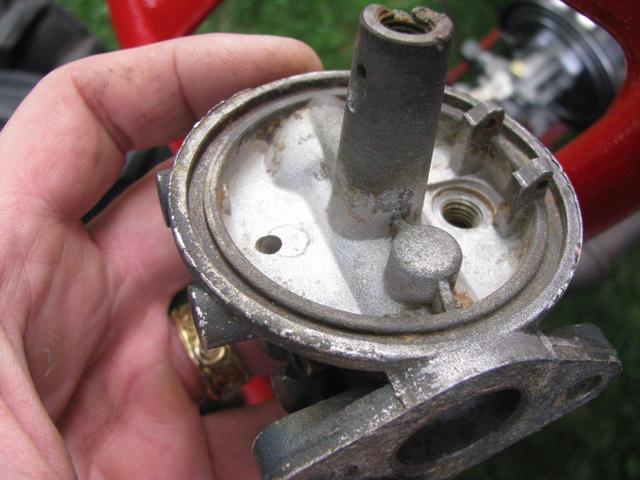

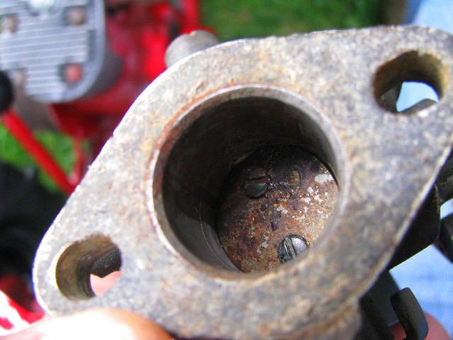

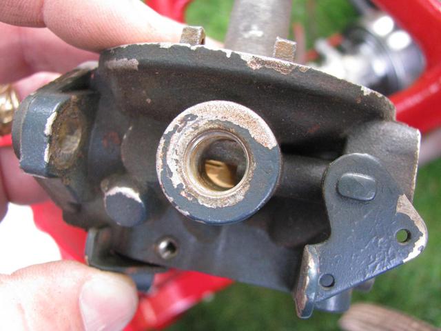

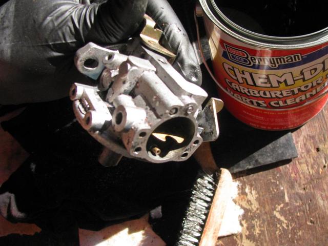

AMC RULES 37,250 #23 Posted August 24, 2013 Well...it ain't black...at least not yet. 14 hours later...paint flakes off easily, seems most of the rust in the bores is gone. Going back in for a couple hours before I hit it with carb cleaner and wire brush. Share this post Link to post Share on other sites
squonk 44,904 #24 Posted August 24, 2013 IT TURNED YOUR HAND BLACK!!! Opps sorry! NICE GLOVES! I just did my Power King carb about a month ago. soaked it over night and the paint was mushy like in your pic. The old stuff would have stripped the paint right off in 2 hrs. Share this post Link to post Share on other sites

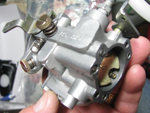

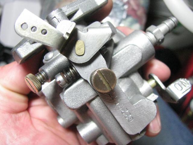

AMC RULES 37,250 #25 Posted August 25, 2013 Turned out not too shabby considering it was my first one, and I was using that neutered crap. Any ideas of how I could test the float before I seal it back up? 2 Share this post Link to post Share on other sites
