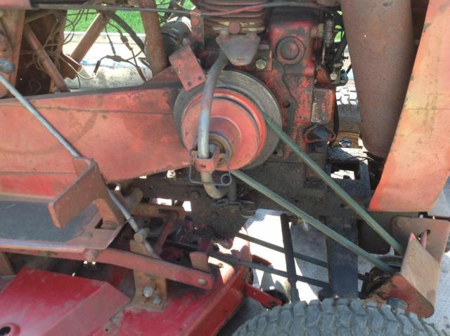

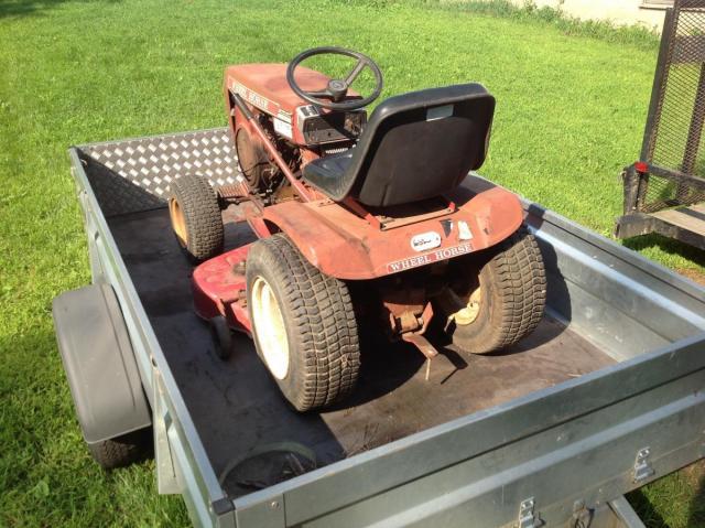

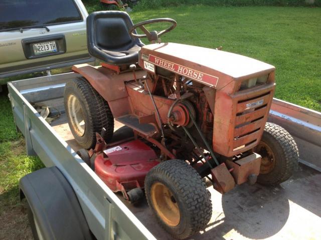

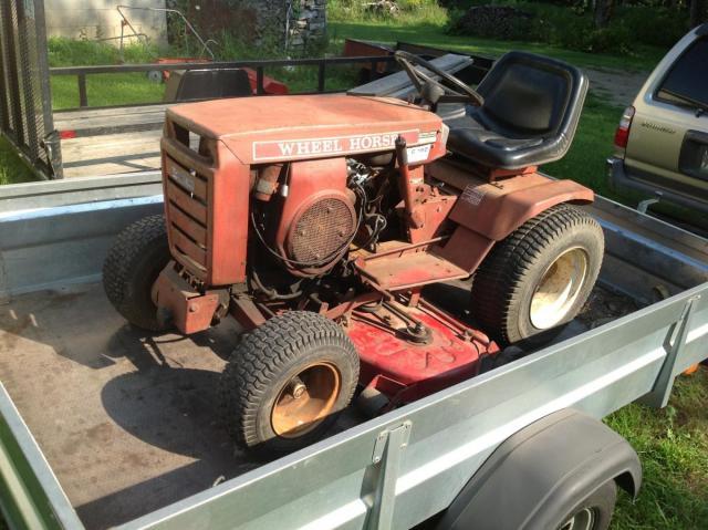

dennist 139 #1 Posted August 20, 2013 Local CL ad C-160 $200 trans not functioning correct, engine runs fine etc. Around here that is enough info to go look anyway. I get there and it was pretty rough, told the guy no thanks and he says $150...no thanks, he says $100...obviously I had to drop the gate to the trailer....Newer 42" RD deck, rear lift and cable, dry cracked tires and plenty of oil and grease everywhere! 4 Share this post Link to post Share on other sites

Trouty56 567 #9 Posted August 21, 2013 Jeez...look at just the seat!!!.....nice!!! Share this post Link to post Share on other sites

leeave96 490 #15 Posted August 21, 2013 Nice looking tractor. Sheet metal looks very straight too. My guess whatever ails this tractor will be a simple fix and you got a great tractor. Good luck, Bill Share this post Link to post Share on other sites

BretzFamily 1 #22 Posted August 23, 2013 (edited) You said it had transmission problems. if its as heavy as.my horse. must of paid for it pushing it up on your trailer alone. Also in third picture in background in the weeds. A horse or a.newer.cookie cutter.mower looks larger Edited August 23, 2013 by BretzFamily Share this post Link to post Share on other sites
