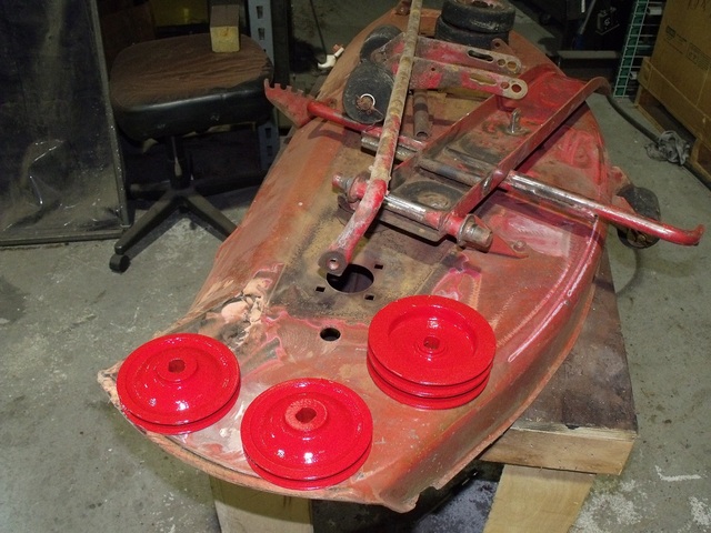

Sycoticca 37 #3 Posted August 16, 2013 Thanks for the info ...I am just trying to get an idea of what I may have to do in the worst case scenerio. I can tell you having to wait a till next month to get the tractor down here from NY is killing me!!.. Sleepness nights with all the dreams of grandure that are going on about once I get it here. Eat ,Sleep, Work wheel horse is all that is going right now...At least I have the mower deck to tinker with right now... Share this post Link to post Share on other sites
