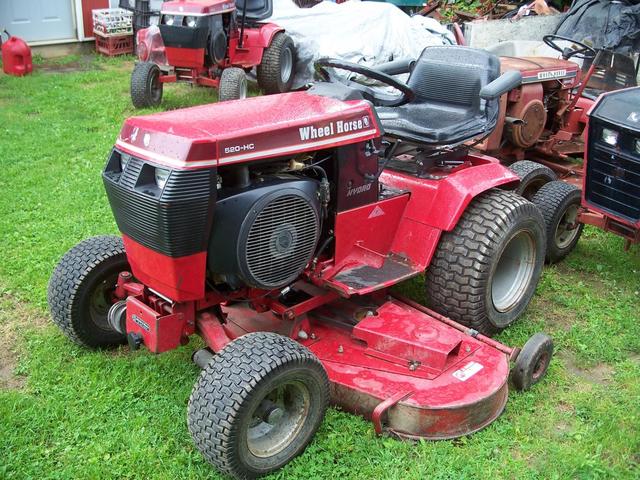

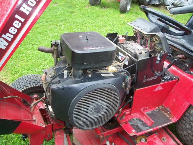

Kelly 1,037 #1 Posted August 7, 2013 I got a call last week about a 520HC with 60" deck, needs a engine, he was the orig. owner, garage kept all it's life, and routine maintenance done, I told him I was busy with the MI WH show so it would have to be this week before I could pick it up, but we agreed on a price over the phone, I got it last night, I have 5 520's right now and have had about 6 others, but this is my first 520 HC it is a plain jane tractor, but it is in pretty good shape considering it has just shy of 1200 hours on it, it sat in his barn for the past 3 years because it had a knock in the engine and he did not want to ruin it, but after pricing Onan stuff it just sat. Tonight I figured I would start it to see what it sounded like, after charging the batt. and cranking it till fuel came up in the filter, it fired right up, no smoke, and no knock??? till I throttled it up and down, then it made a noise but it was not in tune with the engine, I spun the PTO bell and it was noisy so I pulled it thinking no way could it be this easy, well it wasn't, noise still there, but squatted down by the PTO end of the engine running it up and down, I could see the end of the crank moving, and not like it should, but then I noticed the bearing plate was moving with it, so I snugged up the bolts I could get to easy, and tried it again, well the noise is gone, WOO HOO I still need to fix it right and replace the gasket in there and check everything over, but even with 3 year old gas in it, it runs great, trans seems strong, I had planned on parting it out but I may just keep it, I have been looking for a 520 to build in to something and this may be it, The monster 60" deck is going by by, so if you want one send me a PM it will be checked out and listed in the classifieds soon, and the price will be fairly cheap. 1 Share this post Link to post Share on other sites
Sparky-(Admin) 24,648 #2 Posted August 7, 2013 Did you take it for a full throttle spin? They are supposed to be faster than the standard horse. Mike............. Share this post Link to post Share on other sites
Kelly 1,037 #3 Posted August 7, 2013 just got back in from running it pretty hard, it does seem faster, I heard that about them also, I drove it for about 15 min. got it good and warm driving up and down hills, full and part throttle, then I put the front tires against the rear tire on the Farmall H at idle and pushed the DCL forwards all the way, the engine never made a noise and the tires just slowly dug holes, all at idle, so I think the engine will be fine and the trans is strong, steering is nice and tight, all in all a pretty nice machine. Share this post Link to post Share on other sites
