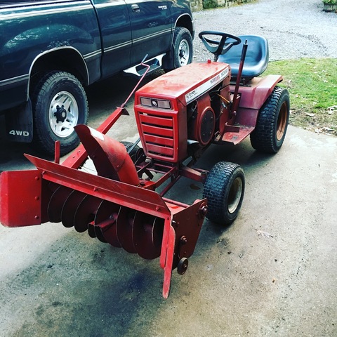

Red144runner 659 #26 Posted December 28, 2016 On 12/7/2016 at 4:59 PM, Fred Jimenez said: This page was super helpful since I needed to make a lift flag for my tractor. After I had the dimensions it only took me an hour to build. Thank you everyone. 96 t100? Share this post Link to post Share on other sites

Ed Kennell 47,333 #29 Posted September 19, 2024 On 12/7/2016 at 4:59 PM, Fred Jimenez said: This page was super helpful since I needed to make a lift flag for my tractor. After I had the dimensions it only took me an hour to build. Thank you everyone. Ya may want to flip the side extensions Fred. When they are installed correctly the blower won't pull you sideways as bad. 1 Share this post Link to post Share on other sites
