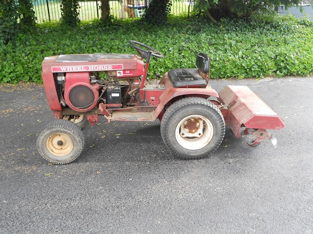

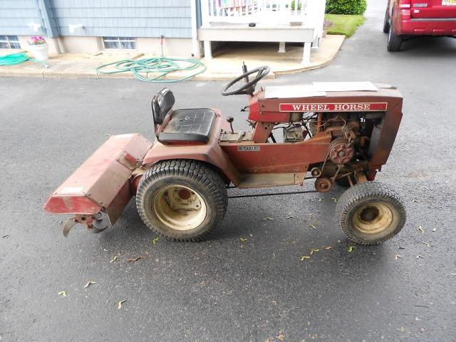

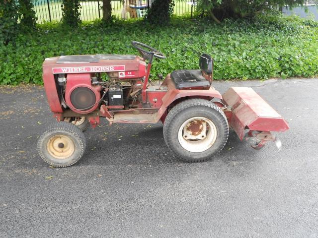

auctioneeral 1 #1 Posted July 30, 2013 just brought this over phone by picture and wordering what model number it is. thanks allen Share this post Link to post Share on other sites
Wheel Horse Kid 105 #2 Posted July 30, 2013 It is a 1973 No Name 12 Automatic. It has a 12 hp Kohler and Automatic Trans. Share this post Link to post Share on other sites
auctioneeral 1 #3 Posted July 30, 2013 Ok thank you very much. what hood would interchange with it. because it needs a hood. I pick it up wedsday night. 1 Share this post Link to post Share on other sites
Sparky-(Admin) 26,686 #4 Posted July 30, 2013 Pretty sure its whats called a long frame tractor so any hood off a "C" series from 1974-1977 should fit just fine without any modifications. A 78-79 "C" series will probably fit as well but I'm not positive on that. Mike.......... Share this post Link to post Share on other sites
Kelly 1,038 #5 Posted July 31, 2013 70 to 79 long frame hoods will fit, you may have to swap the hinges, the 77 up hoods are not drilled for a hood ornament Share this post Link to post Share on other sites
