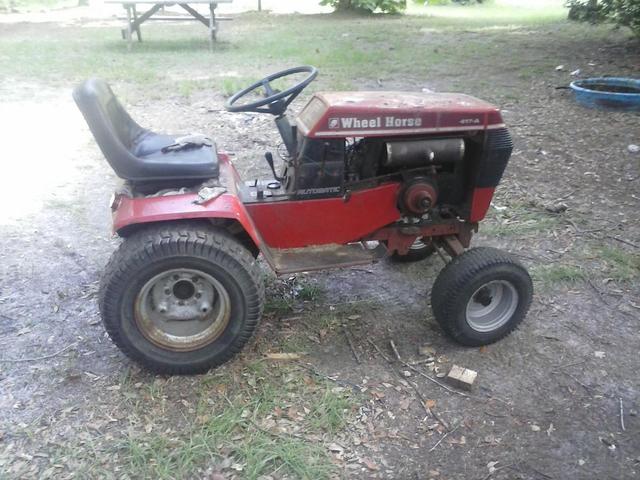

I recently became a Wheel Horse owner. I don't have a manual per say and never owned or worked on something such a brute. I have a couple question and i hope this is the appropiate place.

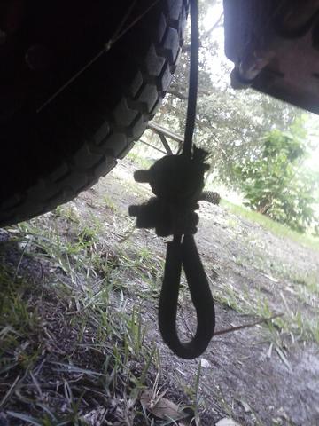

I have a bracket hanging from the lift for the deck and a steel cable with almost same bracket then at the end saof the wire same bracket as front what is that used for?

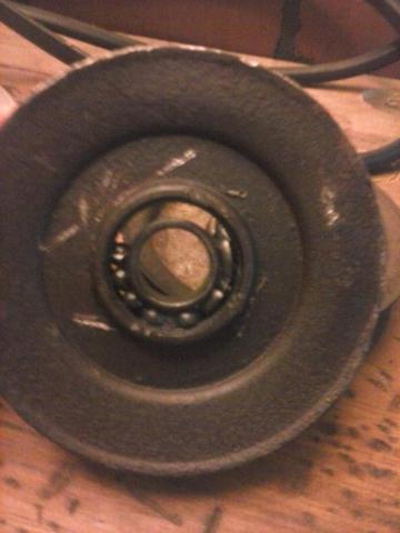

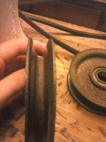

Second my horse still had original belts with part numbers is there a place online where its actually able to get these belts. I also while mowing threw a bearing in the v pulley on the front belt adjuster can i get aftermarket 3/4 pulley .

The cable sounds like the one for the rear attachment lift required for a tiller. Look at the tiller parts list. The lift linkage illustration in the tractor parts list shows what goes where for what.

If you can snap a picture of the bracket and steel wire under the tractor, that would help immensely.

The pulley on your mule drive is replaceable but it would be just plan easier and maybe cheaper to place an add looking for the pulley and again, take a picture so our member/vendors know which pulley went south on you.

Awesome ill go look to ser what's what that makes it easier on all us. Also i included pictures asked for. In the transaxle it smells like sae and looks it don't know what weight it could be. I live in coastal carolina so i would want to stay with a 10w40 year round?
Ok file was to large to show othet end of cable. I also tried to show flat pulley but file to large also so i only got the busted v pulley mowed grass i guess to long for a tractor sittimg for 15years. it started smok. and squealed to a hault i would replace both just to be safe

It did not show up on my phone but your link took me there bookmarked it so easy for me to get well here is what i need.
v pulley 104974
Pulley flat idler 104975
V belt 108834
That would help if they have them.
gwest_ca
v pulley 104974 - Stens 280-750 HD, Napa 7-05486
Pulley flat idler 104975 - Stens 280-743
V belt 108834 - 1/2"x98"
Also try your local Toro dealer
Garry
BretzFamily
Gonna go with stens the cheapest will let you all know when i am all done. thanks for the help
