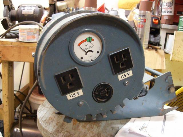

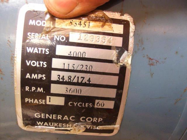

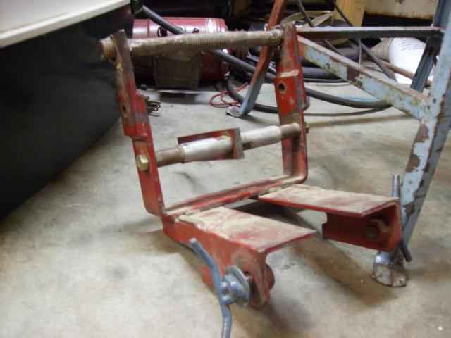

clemedc 29 #1 Posted July 9, 2013 Here is a recent Craigslist (GOOD PRICE) find I picked up its a generAC 4000 Watt generator with 110v and 220v and works excellent. I think the mount for attaching to the mule drive maybe home made but it works well. Does anyone have a manual??? Also does anyone know if my 702 has enough balls to spin this effectively. I have had this on my C125 and I dont want to make a bracket for my 702 if its not capable. Clem Share this post Link to post Share on other sites
pfrederi 19,002 #2 Posted July 9, 2013 A 5000 watt generator usually comes with a 10 hp motor. I think 7hp (especially if it is an older motor) may not be able to run it well at full load. Share this post Link to post Share on other sites
gwest_ca-(File Mod) 11,757 #3 Posted July 9, 2013 Garry Share this post Link to post Share on other sites
KATO 115 #4 Posted July 9, 2013 1 horsepower =746 watts in a perfect world so your "old" 7hp may not be enough at full load but then again it might !! Share this post Link to post Share on other sites
clemedc 29 #5 Posted July 10, 2013 (edited) Thanks to all, sounds like Ill keep it for the C125. Edited July 10, 2013 by clemedc Share this post Link to post Share on other sites
