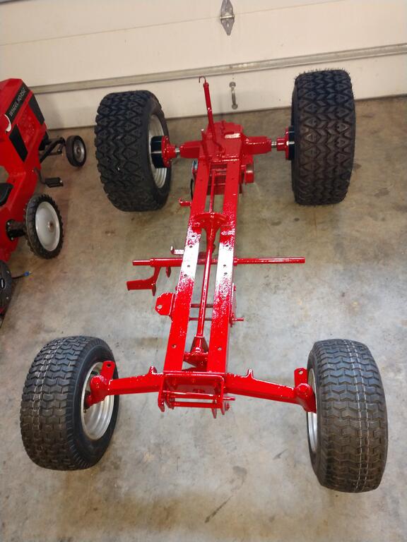

giddyap 1,574 #35 Posted December 7, 2021 Weld a steel triangle on the inside bend. 2 Share this post Link to post Share on other sites
ronhatch 410 #36 Posted December 7, 2021 (edited) I don't get it. Just drill out the original triangle steering plate to accept the larger ball joints and adjust the new tie rods for a little toe in. Job done. And don't overload the bucket. Edited December 7, 2021 by ronhatch Share this post Link to post Share on other sites
Jeff-C175 7,207 #37 Posted December 7, 2021 I know some added info could be useful to someone searching in the future, but keep in mind that this post is almost ten years old, and the OP has not been back since 2017. 2 Share this post Link to post Share on other sites
kpinnc 17,147 #38 Posted December 8, 2021 On 7/18/2013 at 1:09 PM, 520h driver said: Does the JD front axle fits My 520h too? Would be NICE, can't find Any forward swept axels! Btw Any pictures? I will jump in and agree- they are decent axles. You'll need a spacer, as the pivot pin on a JD is shorter. You may also need to modify the spindle steering tabs and make a set of turnbuckles, or at least I did on mine. The axle is solid, but sits quite a bit lower than WH- about 3/4 if memory serves. And there are alot of them out there. Share this post Link to post Share on other sites
