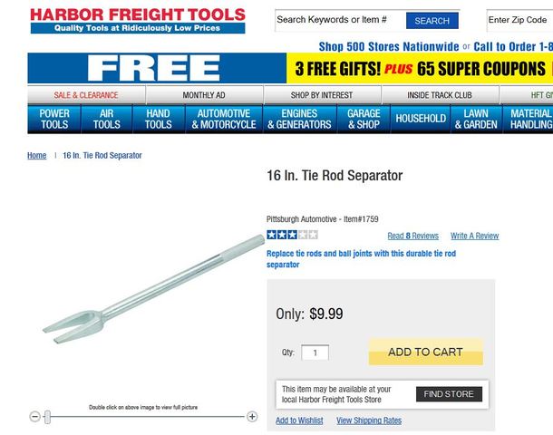

pfrederi 20,323 #8 Posted April 29, 2014 The tool is called a pickle fork. You drive it between the ball joint and the spindle. You might be able to get one on loan from an auto parts store. Share this post Link to post Share on other sites
chdinct 28 #9 Posted April 29, 2014 The tool is called a pickle fork. You drive it between the ball joint and the spindle. You might be able to get one on loan from an auto parts store. For $10, I'll probably pick one up since I have to take back the grease joint rejuvenator I bought at HF anyway. The rejuvenator is on closeout from HF and now I know why - dosen't work. Ha. Thanks for the suggestion. Any others? Share this post Link to post Share on other sites

shorts 182 #11 Posted April 29, 2014 A pickle fork will probably destroy the rubber boot and possibly the ball & socket also, the tapered shaft and lever arm that it fits In are pulled up tight and holding as designed, to disassemble without damaging the parts you need to momentarily distort the tapered hole, back up one side of the lever with a bfh and then hit the opposite side with another hammer and the tapered pin should fall out Share this post Link to post Share on other sites
chdinct 28 #12 Posted May 7, 2014 Update. Got the ball joint out finally. I ended up buying a ball joint removal tool from Harbor Freight when I returned the grease zerk rejuvenator, which didn't work. The tool is not the one pfrederi pictured above. It's the version that clamps underneath the joint and then you screw down the forks against the clamp (easier to post a link than describe - http://www.harborfreight.com/3-4-quarter-inch-forged-ball-joint-separator-99849.html). So, I spent some time the last few days trying to clean out the old grease by turning it over and putting carb cleaner into the joint, letting it sit awhile, then manually rotating in in all directions. There's definitely some additional friction in one direction vs all others. Anyway, repeated this several times, then put the zerk back and tried to grease it. No go, still won't take grease. At this point, I'm looking for a replacement. Here's my question: Did the D series use the same ball joints/tie rod ends as the 520s? Looking at pics on ebay, there are several D series ball joints for sale that look exactly like the one on my 520H, but the part numbers are different so I haven't pulled the trigger. There's a new 520 ball joint for sale, but the price with shipping is what I'd pay from a local dealer, so passing on that. Thanks for any help. Share this post Link to post Share on other sites
