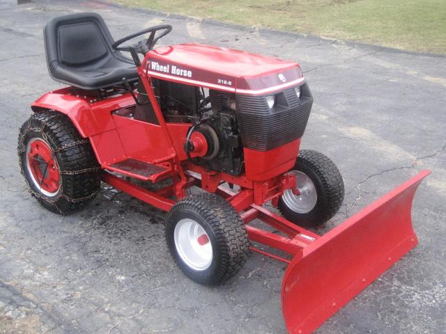

stevebo-(Moderator) 8,664 #2 Posted July 2, 2013 Sounds like something I did on an older restore. I had an extra c series muffler which I really liked and it fit pretty well on my 312 but was too hot. I wrapped it with header tape and when I sold it told the buyer that he needed to change the muffler or it will burn the new paint. Share this post Link to post Share on other sites
