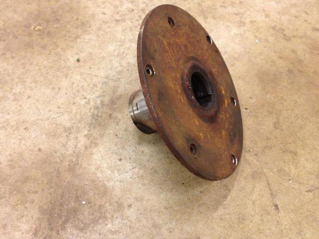

stevebo-(Moderator) 8,664 #1 Posted July 2, 2013 All- I picked up a pto set up for my 953 but I am missing a few things. The backing plate has the 4 holes to bolt to a drive pulley however the drive pulley on mine has no holes. Can anyone tell me what drive pulley I need? Size and shaft diameter? I am also missing the plain bearing that goes over the crank shaft and inside the pto housing. If anyone can help I would appreciate it. Share this post Link to post Share on other sites

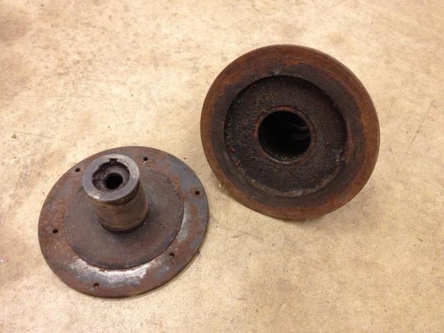

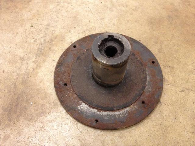

Martin 2,134 #4 Posted July 2, 2013 heres a pic or 3 of what i have.... i think the roller bearing is a different size than the later pto bearings, maybe the seal as well ? im not sure about the washer welded in the end of the sleeve........ the manual should help too........ Share this post Link to post Share on other sites
