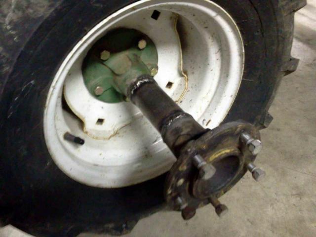

Dieselcowboy 211 #1 Posted June 30, 2013 Thought you all would like to see my version of home made hub mount duals. I do make a lot of my own attachments. Things can be pricy or rare to find. Maybe this can help some of you. Parts list contains - 4 JD 110 hubs - 2 pipes - cast welding rod - 1 imagination 4 Share this post Link to post Share on other sites
Tankman 3,523 #2 Posted July 1, 2013 Great idea! A local junqué has hundreds of garden tractors, scrap. I frequently just walk his yard and pick 'n pull small items. Two hubs are now on my list! Mounting the hubs as you've done, longer stud bolts through the hub extension into your Horses hubs. Did you use 1/2" longer stud bolts? My horses hubs have 7/16-20 x 1-1/2" long bolts installed from the back of the hub. Blue threadlocker on the threads that are in the hub. I then use 7/16-20 open acorn lug nuts. Makes mounting wheels much easier for this old guy (pics ). Share this post Link to post Share on other sites
