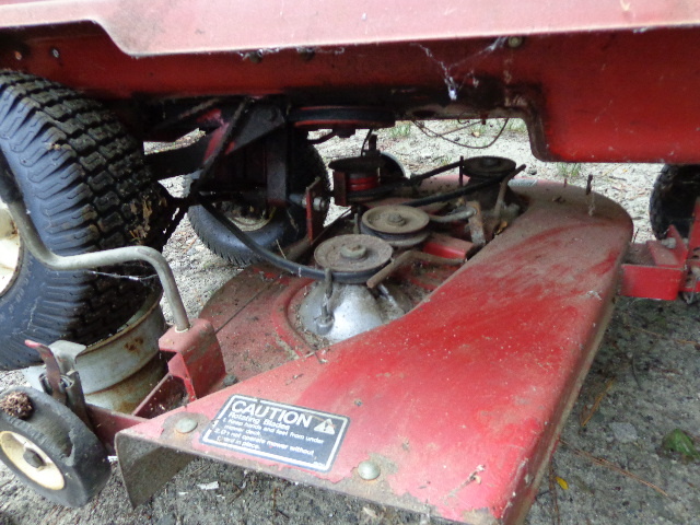

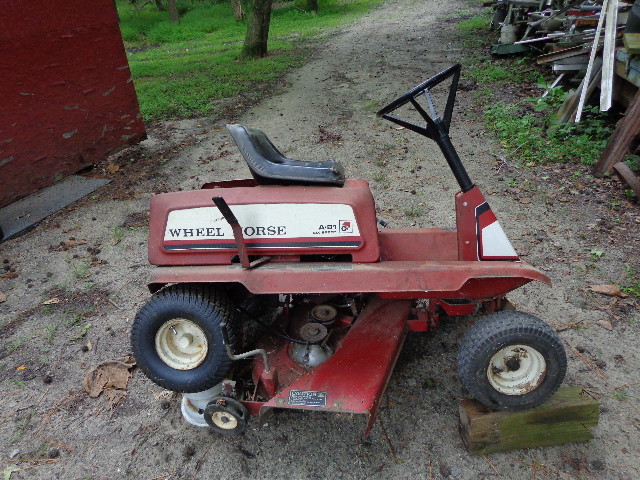

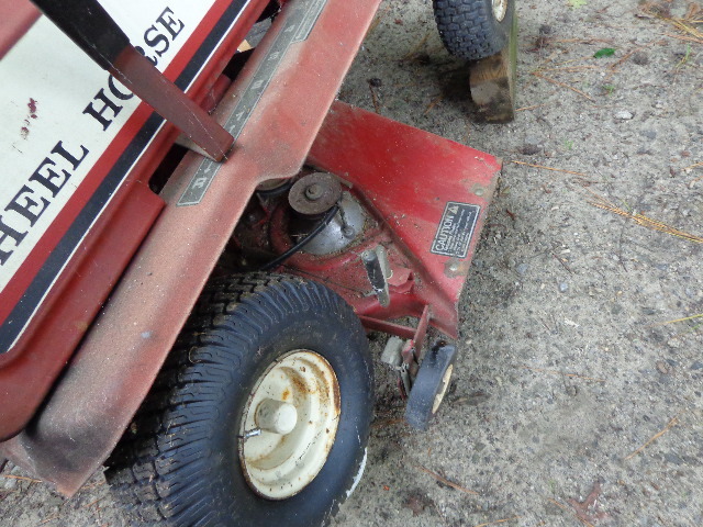

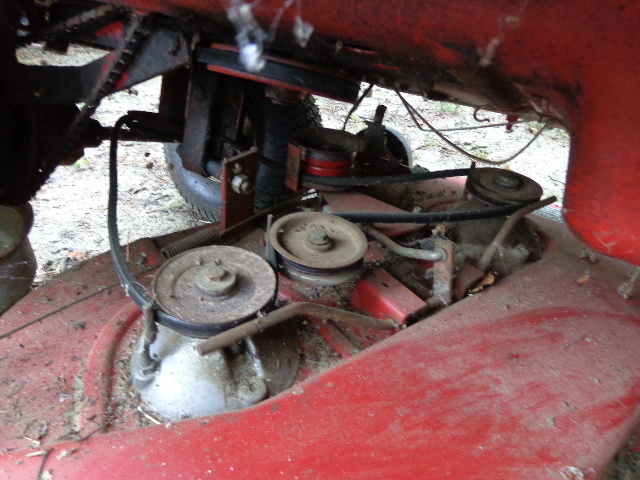

jay in nc 210 #2 Posted June 30, 2013 ok there is a lever on the rt. side of the deck that engages the blades, the height adj. is done at the deck wheels ala push mower style. hope the pictures help. I love my A 81 ! 1 Share this post Link to post Share on other sites
