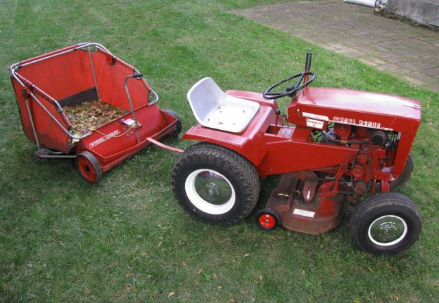

Ken B 3,202 #42 Posted July 6, 2013 I picked up this real nice lawn sweeper from Craig, (AMC Rules Giddyup) at the BIG SHOW. I should have got one of these a long time ago! The Big Brown truck dropped off the handle yesterday Craig. Thanks for shipping it. 1 Share this post Link to post Share on other sites
AMC RULES 37,254 #43 Posted July 7, 2013 Awesome Ken, glad you like it. Don't those things work great, have you tried dumping it from the seat yet? Share this post Link to post Share on other sites
Wheel Horse Kid 105 #44 Posted July 8, 2013 WOW! You are fast on your refurbs Ken! Great Job! That sweeper and 417 look like they were made for each other! Share this post Link to post Share on other sites
