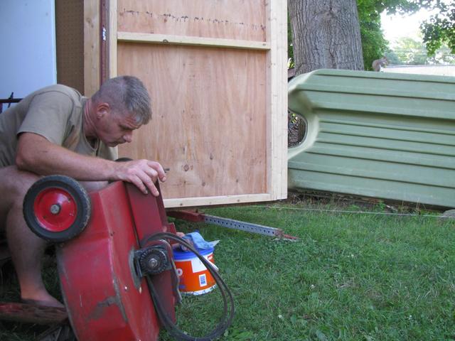

AMC RULES 37,223 #3 Posted June 29, 2013 Get lot's of rags! Lot's of rags. Share this post Link to post Share on other sites
squonk 44,149 #4 Posted June 29, 2013 Do you have your sandals on in that pic young feller? :ychain: 1 Share this post Link to post Share on other sites
AMC RULES 37,223 #5 Posted June 29, 2013 Nope, just my banana hammock. Share this post Link to post Share on other sites
