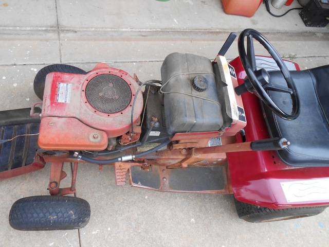

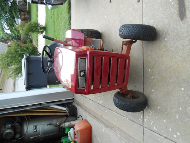

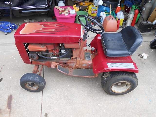

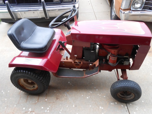

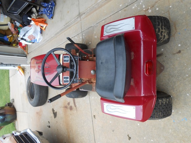

ironhorse 0 #1 Posted June 23, 2013 My dad has had a Wheel Horse since the early sixties. This is one of his that he let me use. I want to fix some things for him and can not find a serial number or model for the parts guy at Toro. Any help would be appreciated. Thanks in advance. More pics. Share this post Link to post Share on other sites
whfan74 2,072 #2 Posted June 23, 2013 My guess is a B-82......again, just a guess. Share this post Link to post Share on other sites
gwest_ca-(File Mod) 11,499 #3 Posted June 23, 2013 The 1981 B-82 operator manual http://www.wheelhorseforum.com/files/file/367-tractor-1981-b-series-and-c-series-om-part2-810233r1pdf/ http://www.wheelhorseforum.com/files/file/1187-tractor-1981-b-series-and-c-series-om-part3-810233r1pdf/ http://www.wheelhorseforum.com/files/file/1601-tractor-1981-b-series-and-c-series-om-part4-810233r1pdf/ http://www.wheelhorseforum.com/files/file/1537-tractor-1981-b-series-and-c-series-om-part5-810233r1pdf/ Parts lists and attachment lists are here using model numbers 02-08BP01, 02-08BP02 or 02-08BP03 https://lookup3.toro.com/partdex/index.cfm?xCaller=Toro Garry Share this post Link to post Share on other sites

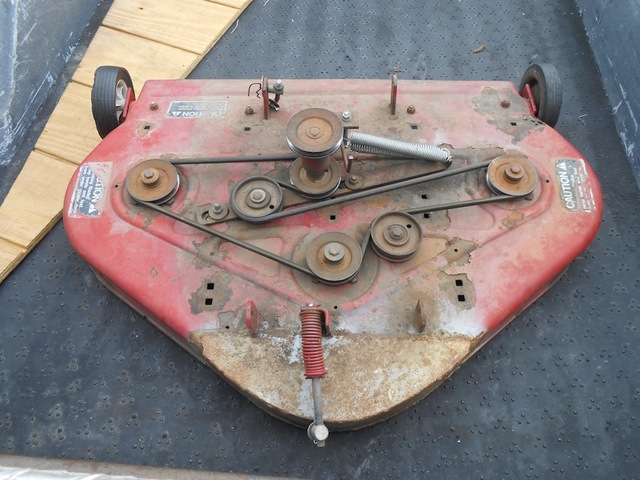

ironhorse 0 #4 Posted June 24, 2013 Thank you guys for the reply. Needed a main drive belt (stretched) and belt to mower deck pulley (think dad put a automobile belt on it). The guy at the Toro parts told me that the main spindle bearing for the deck is no longer made. The rest of the bearings for the pulleys, he has. Is this correct? So far they are tight but hard to tell which pulley bearing is making all the noise. Thought I might try replacing all of them on the deck. Thoughts? Garry, Thank you very much for the download, after seeing where the ID. plate was (couldn't believe I missed that), I found these numbers: What exactly do they mean? ID. 72-08BP01-2691 6348 Share this post Link to post Share on other sites
Callen 64 #5 Posted June 24, 2013 It is a '77 A-90. Share this post Link to post Share on other sites
gwest_ca-(File Mod) 11,499 #6 Posted June 24, 2013 Thank you guys for the reply. Needed a main drive belt (stretched) and belt to mower deck pulley (think dad put a automobile belt on it). The guy at the Toro parts told me that the main spindle bearing for the deck is no longer made. The rest of the bearings for the pulleys, he has. Is this correct? So far they are tight but hard to tell which pulley bearing is making all the noise. Thought I might try replacing all of them on the deck. Thoughts? Garry, Thank you very much for the download, after seeing where the ID. plate was (couldn't believe I missed that), I found these numbers: What exactly do they mean? ID. 72-08BP01-2691 6348 Here is the correct manual and a few service bulletins Transmission parts list The model number is 72-08BP01 The serial number is 2691 but if you go to Toro and they ask for the serial number do not enter it. Use the word none for a serial number. 6348 is the Julian build date 348th day of 1976 = Monday December 13, 1976. Have learned this is not the day they built it but is the day they scheduled it to be built. Parts lists are here https://lookup3.toro.com/partdex/index.cfm?xCaller=Toro but be careful. These are shared by similar models so an item may be listed more than once with different part numbers but fails to tell us what model uses what. To print the pages click on the small printer icon at the top left of each illustration. Garry Share this post Link to post Share on other sites
ironhorse 0 #7 Posted June 24, 2013 Thanks Garry, I spent some time on the computer but have yet to find anything on the mower deck or the pulleys or bearings. If they don't exist what does a person do for parts? Can they be repacked? No fitting that I can find on them to oil them. There are extraordinary machines here, people really have a passion for their tractors. Great site. Wish I had found it much earlier. Share this post Link to post Share on other sites
gwest_ca-(File Mod) 11,499 #8 Posted June 24, 2013 Some service bulletins on the mower deck Parts list is here for the 75-36MR01 https://lookup3.toro.com/partdex/index.cfm?xCaller=Toro There is also a 75-36MR02 and don't know what the difference is. This is all I have found so far. I know Toro no longer carries the spindle bearing but still available from Stens and Napa. Garry Share this post Link to post Share on other sites
ironhorse 0 #9 Posted June 24, 2013 Super, I will give them a try. Share this post Link to post Share on other sites
