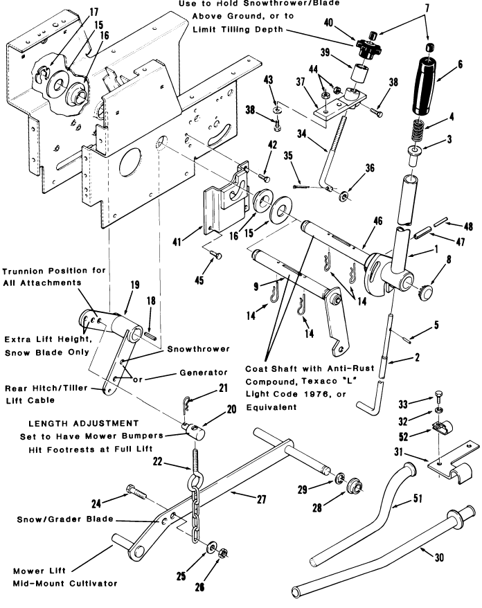

david wheatley 2 #1 Posted June 23, 2013 Hi ,been out mowing today.when I was finished I couldn't raise the deck.after investigating ,I found that whatever linked the lift lever to the hydraulic bit has fallen off.can any one point me in the direction of what the linkage looks like or where I can get a new one ?im in the uk,thanks in advance! Share this post Link to post Share on other sites
Sparky-(Admin) 26,272 #2 Posted June 23, 2013 Not totally sure but I bet you lost the small chain, eyebolt and trunnion. Mike............. Share this post Link to post Share on other sites
Sparky-(Admin) 26,272 #3 Posted June 23, 2013 In this pic its parts # 20, 21, and 22 (Click on the diagram and it'll get bigger) Mike........... Share this post Link to post Share on other sites
david wheatley 2 #4 Posted June 23, 2013 Thanks mike,my deck lifter is a hydraulic one.at least the deck is in the lowered position,so I can still cut the grass! I will try and get a photo, it's hard to describe the missing bit as I have never seen it! Share this post Link to post Share on other sites
Jeff-C175 7,211 #5 Posted June 23, 2013 In that diagram, item #9 is used for the hydraulic lift, item #46 is for the manual lift. The hydraulic cylinder attaches to the hole in the lever on item 9. There is a clevis with a pin that attaches the cylinder to the lever. Item #19 is keyed to shaft item #9. Follow the dotted lines and you will see how it all fits together. Share this post Link to post Share on other sites
